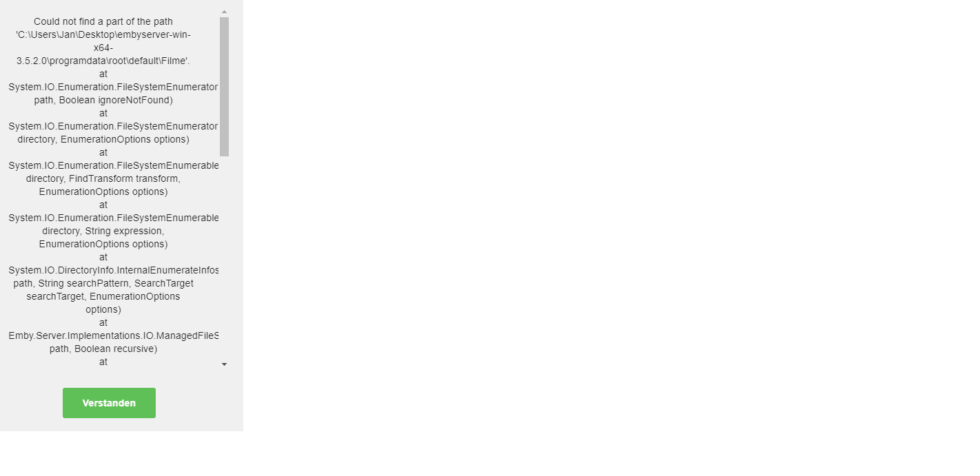

jaysn8 0 Posted October 10, 2019 Posted October 10, 2019 Hey guys, I am stuck with getting my media library scanned -Emby doesnt scan it any longer since I updated my portable setup from 4.0 to 4.2.1 recently. The scan is always failing with the notification "Scan media library failed". When I hit the "i" button the following error message is being displayed: The libraries have been created years ago. Everything is running locally on a Win Server 2016 (portable). The server logs are attached. Can somebody tell what I can try to have my libraries scanned again? Thanks guys! embyserver.txt

Luke 42217 Posted October 10, 2019 Posted October 10, 2019 Yes that's correct. Looks like you may have moved the portable install folder, right? It used to be here? C:\Users\Jan\Desktop\embyserver-win-x64-3.5.2.0
jaysn8 0 Posted October 10, 2019 Author Posted October 10, 2019 Exactly. In the beginning it was running from the desktop folder and a couple of months ago I moved the entire folder to a permanently backuped folder on another local hard drive. Can I fix this somehow?

Luke 42217 Posted November 3, 2019 Posted November 3, 2019 @@jaysn8, are you still having an issue with this? @@Happy2Play he might might be able to surgically repair his libraries by shutting down the server and then editing the paths stored in the files under /programdata/root/default If that doesn't help then deleting the library.db file would be an option, or a less destructive route would be to remove the libraries from Emby library setup, running a full scan to clear the database, and then adding them back.
jaysn8 0 Posted November 3, 2019 Author Posted November 3, 2019 @@Luke Thanks for your efforts. I decided to make a clean install to have all paths correctly. Now everything works perfectly fine. Thanks again.
