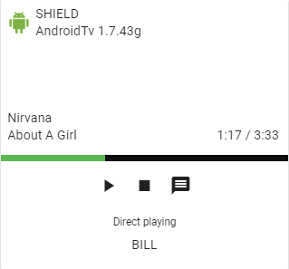

Bill4sman 10 Posted August 28, 2019 Posted August 28, 2019 Does Emby downsample audio to 48KHz 16 bit? I'm streaming through Nvidia Shield and it's showing 48KHz 16 bit even though my source file is VERIFIED to be 24 bit.

Bill4sman 10 Posted August 29, 2019 Author Posted August 29, 2019 (edited) The other apps I use DO playback 24bit audio like Tidal and my preamp displays the bitrate. EVERYTHING from Emby shows 48KHz 16bit and it IS direct playing. Sorry for bringing this up but Plex DOES play the files at the correct bitrate. So, this is back to Emby in terms of the app NOT supporting anything better than 48KHz 16bit. I'm really hoping this is a checkbox somewhere... Edited August 29, 2019 by Bill4sman

ebr 16313 Posted September 5, 2019 Posted September 5, 2019 Hi. Can you determine under exactly what conditions it appears to play at the higher rate vs. not? It is direct playing via the app but does appear to be downsampled to 48khz (based on the limited info I can get from my receiver). Cannot confirm the bitrate. Since it is direct playing it must be the FLAC extension we are using that is downsampling it.
Bill4sman 10 Posted September 5, 2019 Author Posted September 5, 2019 Yes, if I play from ANY Emby app directly it will not exceed 16bit but if I Cast to the Shield, it plays trhe correct bitrate.

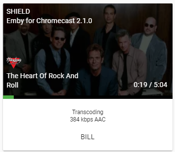

Bill4sman 10 Posted September 5, 2019 Author Posted September 5, 2019 (edited) And it's transcoding Edited September 5, 2019 by Bill4sman
ebr 16313 Posted September 5, 2019 Posted September 5, 2019 Exactly how are you "casting" it? That tile doesn't look like it is actually transcoding as there is no transcode progress. Was an ffmpeg log produced?
Bill4sman 10 Posted September 5, 2019 Author Posted September 5, 2019 (edited) I cast from my PC and it works. Cast from Android app does NOT work because I cannot choose Shield Chromecast from app? ffmpeg-transcode-29c87f1d-8f09-4fb5-bdae-c7ce1a474dde_1.txt ffmpeg-transcode-d9128fba-ece5-476e-9d1f-3c993c42605d_1.txt Edited September 5, 2019 by Bill4sman
ebr 16313 Posted September 5, 2019 Posted September 5, 2019 Okay, when you play it via Android Mobile, it is transcoding it. If you play it directly in Android TV, it will direct play it. However, that does appear to still downsample.
