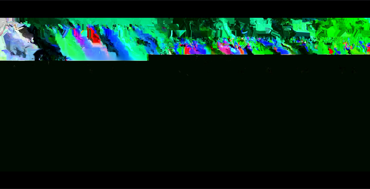

Riddler84 54 Posted July 22, 2023 Posted July 22, 2023 On 9/28/2019 at 9:55 AM, softworkz said: QuickSync D3D11 is an Emby-exclusive feature that nobody else has right now - but as cool as that is, it might be the culprit in this case.. Stumbled across this, because I was looking for a reason, why transcoding of HEVC files always produces nothing but a colorful blocky pixelated mess, instead of a clear picture. Didn't know it had anything to do with the decoding of 10 bit files. Most of my files are, so I couldn't directly see, that this is the reason. So I found out, that the reason for it not working, was the "QuickSync Intel Iris Xe Graphics - D3D11 - H.265 (HEVC)" decoder. It works fine with the D3D9 one and DX11VA. But if there are known problems with D3D11 (that's what I'm reading out of your posts), why is this decoder activated by default and put into the highest priority slot, over the two others? Why having it even in there, if it's not as stable as the other ones? It took me a good amount of time, figuring out, why transcoding sometimes doesn't work, while other times it works well.
Luke 42287 Posted July 24, 2023 Posted July 24, 2023 On 7/21/2023 at 8:03 PM, Riddler84 said: Stumbled across this, because I was looking for a reason, why transcoding of HEVC files always produces nothing but a colorful blocky pixelated mess, instead of a clear picture. Didn't know it had anything to do with the decoding of 10 bit files. Most of my files are, so I couldn't directly see, that this is the reason. So I found out, that the reason for it not working, was the "QuickSync Intel Iris Xe Graphics - D3D11 - H.265 (HEVC)" decoder. It works fine with the D3D9 one and DX11VA. But if there are known problems with D3D11 (that's what I'm reading out of your posts), why is this decoder activated by default and put into the highest priority slot, over the two others? Why having it even in there, if it's not as stable as the other ones? It took me a good amount of time, figuring out, why transcoding sometimes doesn't work, while other times it works well. Hi, can we please see a specific example? Thanks.
softworkz 5135 Posted July 25, 2023 Posted July 25, 2023 On 7/22/2023 at 2:03 AM, Riddler84 said: Stumbled across this, because I was looking for a reason, why transcoding of HEVC files always produces nothing but a colorful blocky pixelated mess, instead of a clear picture. Didn't know it had anything to do with the decoding of 10 bit files. Most of my files are, so I couldn't directly see, that this is the reason. So I found out, that the reason for it not working, was the "QuickSync Intel Iris Xe Graphics - D3D11 - H.265 (HEVC)" decoder. It works fine with the D3D9 one and DX11VA. But if there are known problems with D3D11 (that's what I'm reading out of your posts), why is this decoder activated by default and put into the highest priority slot, over the two others? Why having it even in there, if it's not as stable as the other ones? It took me a good amount of time, figuring out, why transcoding sometimes doesn't work, while other times it works well. The decoder works fine and better than the others, especially when it's about setting up media processing pipelines which are fully done in hardware. If you are seeing issues, this is most likely due to graphics drivers. Please download and install the latest graphics drivers from the Intel.com website. If you are already on the very latest drivers, you can try an older driver version from a few months ago, but I'm not aware of any current issues.
Riddler84 54 Posted July 25, 2023 Posted July 25, 2023 23 hours ago, Luke said: Hi, can we please see a specific example? Thanks. 16 hours ago, softworkz said: The decoder works fine and better than the others, especially when it's about setting up media processing pipelines which are fully done in hardware. If you are seeing issues, this is most likely due to graphics drivers. Please download and install the latest graphics drivers from the Intel.com website. If you are already on the very latest drivers, you can try an older driver version from a few months ago, but I'm not aware of any current issues. I wanted to write a follow up to this, because with the D3D9 decoder, tonemapping wasn't working at all. Protocol just said: "Warning: Tone Mapping would be desired, but QuickSync tone mapping requires the 'D3D11' codec versions. D3D9 Adapter: 0" But then I noticed, during some Beta testing, that none of my current transcoding and tonemapping issues are present there. So I switched to Beta fully (thought about it anyway). D3D11 and D3D9 decoders aren't even present there. Only one left is "QuickSync Intel Iris Xe Graphics" plus the DX11VA one. Regarding the problem with the stable version, I am using the latest Intel Media Driver ver. 31.0.101.3790. OS is Windows 10. I attach a screenshot of how it looked for the entirety of the movie.
softworkz 5135 Posted July 25, 2023 Posted July 25, 2023 46 minutes ago, Riddler84 said: I am using the latest Intel Media Driver ver. 31.0.101.3790. OS is Windows 10. This driver is more than 6 months old and the initial ARC/Iris XE drivers had lots of issues. 47 minutes ago, Riddler84 said: D3D11 and D3D9 decoders aren't even present there. Only one left is "QuickSync Intel Iris Xe Graphics" plus the DX11VA one. This is correct. All decoders on Windows are DX11 now (and only). D3D9 variants are not shown any longer. There's a diagnostic flag to activate these, but there's really no reason to do that in your case, no benefit to expect, only drawbacks.
softworkz 5135 Posted July 25, 2023 Posted July 25, 2023 Use the latest one, which is - as of today - 4575: https://www.intel.com/content/www/us/en/download/726609/intel-arc-iris-xe-graphics-whql-windows.html
Riddler84 54 Posted July 27, 2023 Posted July 27, 2023 On 7/25/2023 at 10:48 PM, softworkz said: This driver is more than 6 months old and the initial ARC/Iris XE drivers had lots of issues. Ok, but the Intel control center on my Intel NUC said that the version I posted was indeed the latest. Now you made me curious, and I installed the Intel driver assistant software, which found 3 outdated drivers, graphics included. Ironically, the control center now acknowledges that the driver is outdated^^ But it doesn't recommend the version you posted, it does recommend the 4369 one, specifically for NUC11 systems. On 7/25/2023 at 10:48 PM, softworkz said: This is correct. All decoders on Windows are DX11 now (and only). D3D9 variants are not shown any longer. But something you did, fixed it for me, even with the outdated graphics driver I was using. So it wasn't just the driver, right?
softworkz 5135 Posted July 30, 2023 Posted July 30, 2023 (edited) On 7/27/2023 at 6:29 PM, Riddler84 said: Ok, but the Intel control center on my Intel NUC said that the version I posted was indeed the latest. Now you made me curious, and I installed the Intel driver assistant software, which found 3 outdated drivers, graphics included. Ironically, the control center now acknowledges that the driver is outdated^^ But it doesn't recommend the version you posted, it does recommend the 4369 one, specifically for NUC11 systems. In earlier days, Intel had a driver model with primary focus on OEMs, like mainboard manufacturers. Those OEMs were provided base driver versions by Intel and could customize them and release them as their own - branded - versions of the drivers. The idea is that the OEMs are testing the drivers to be compatible with their own specific hardware (mainboard+firmware). Those procedures haven't changed, but earlier it wasn't (easily) possible to install the Intel (plain-vanilla) drivers on top of those drivers (once installed). This is what has changed 2 years ago: You can always install Intel's drivers on top of other drivers - probably because it has turned out that the board manufacturers are updating their OEM versions rarely and often completely stop updating after 1-3 years. Testing new drivers costs time and money - so what's remaining is that "recommended" (= tested) driver versions are always behind the latest Intel driver versions - sometimes even far behind. For >90% of cases, it doesn't matter a lot, because users aren't expecting much more than proper display of their desktop UI. For media hardware acceleration it's a different story. The initial Iris/Arc drivers had tons of issues in this area, but it's not something cared by those who determine and release the "recommended driver versions" for specific hardware (even when it's Intel itself - but another department). So the golden rule for using Intel Media Hardware Acceleration with Emby: Always go to the Intel Support Site and download the latest drivers for your graphics hardware! Edited July 30, 2023 by softworkz 2
