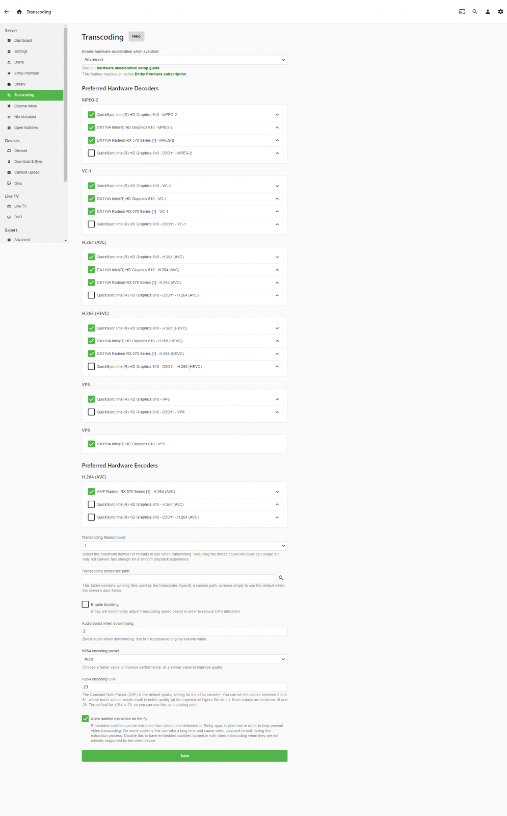

zyfinity 15 Posted September 29, 2019 Author Posted September 29, 2019 (edited) Ok, here it is all the logs from different tests consisting of, 1080p HEVC, 1080p HEVC 10bit, 4k HEVC and 1080p H.264 transcoding For all of the tests it seems that hw accelerated decoding and encoding didnt work even though it tried selecting it in the logs. Screenshot of what i had selected is attatched. All four FFMPEG logs are attatched. Hardware detection log is attatched. @@softworkz hardware_detection-63705358506.txt ffmpeg log 1.txt ffmpeg log 2.txt ffmpeg log 3.txt ffmpeg log 4 (h264).txt Edited September 29, 2019 by zyfinity

softworkz 5135 Posted September 29, 2019 Posted September 29, 2019 Any progress? Could you please try using the QuickSync H264 encoder instead of the AMF encoder? Probably, the problem is caused by the combination of QuickSync and AMF. The following combinations should work: QuickSync Decoder and QuickSync Encoder DX11VA Decoder and AMF encoder
zyfinity 15 Posted September 29, 2019 Author Posted September 29, 2019 I have tried with the encoder completely off and with quicksync on for encoding and had the exact same results as with the Rx 570

softworkz 5135 Posted October 4, 2019 Posted October 4, 2019 (edited) Thanks for the log files and please take my apologies for the bad experience. You've actually been the victim of 3 different issues: Emby should prevent the use of any hw decoder except DXVA/DX11VA Affects: Release + Beta => Status: Unresolved . 10bit color conversion issues in certain configurations Affects: Release + Beta => Status: Unresolved . QuickSync initialization (regression bug) Affects: Beta only => Status: Fixed What you've already noticed is the fix of #3 #1 can be worked around by configuration #2 will need some major rework on our side - but it's already being worked on! Your best option for transcoding 10bit HEVC video is to disable HEVC hardware decoders. Encoding is the heavy-work part in transcoding anyway, so it's most important to have the encoding accelerated. Be sure to use this together with throttling activated (otherwise you'll see high cpu load). Thanks for your patience! Edited October 4, 2019 by softworkz
