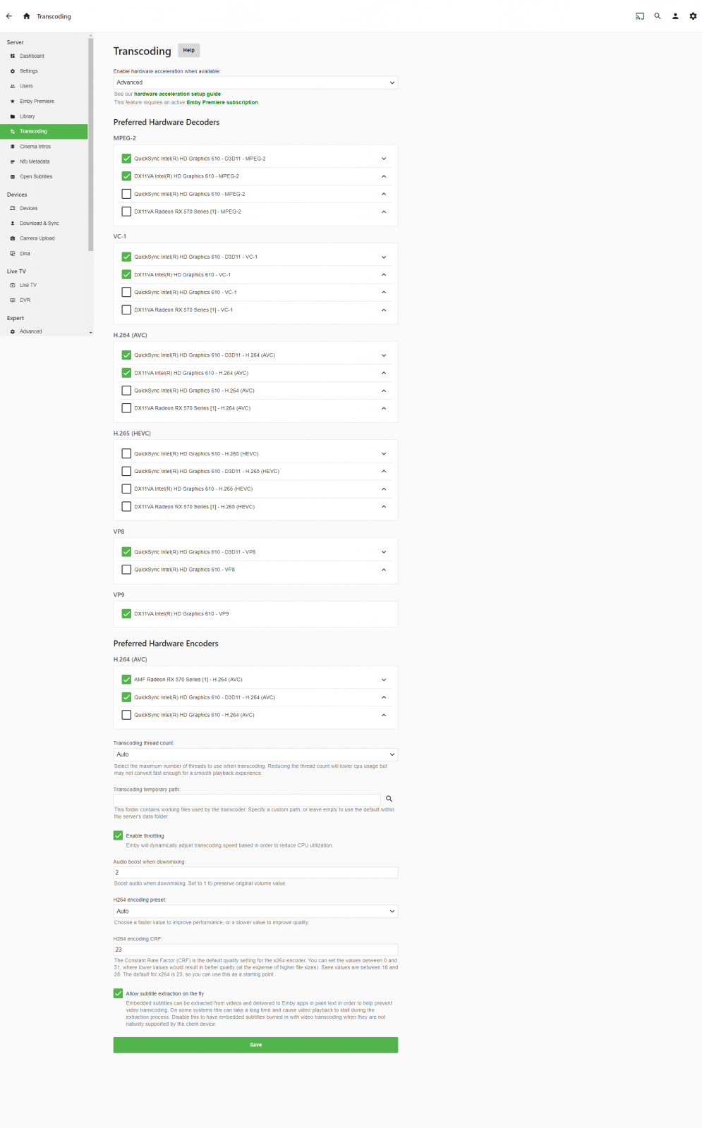

zyfinity 15 Posted September 28, 2019 Author Posted September 28, 2019 (edited) Umm actually i havent posted the logs from the other machine yet, all the logs posted are from one machine, and secondly i dont have the D3D9 option? (picture attatched showing what i have) Also how does emby not allow transcoding of 10bit video where others such as plex and jellyfin do? is there a misunderstanding or something because isnt jellyfin based off a fork off emby? i really hope the issue can be solvable. @@softworkz Edited September 28, 2019 by zyfinity

zyfinity 15 Posted September 28, 2019 Author Posted September 28, 2019 These are the options i get with it connected to the igpu
softworkz 5135 Posted September 28, 2019 Posted September 28, 2019 Great. Disable all D3D11-QuickSync codecs and enable those without D3D11 in the name (also move them to the top or disable the others in each group)
zyfinity 15 Posted September 28, 2019 Author Posted September 28, 2019 (edited) ok here are my results, its still not decoding through quicksync and along with that it isnt encoding with my rx 570 (it only encodes when i disable all h265 decoders) the log and screenshot of my current settings are attatched below @@softworkz ffmpeg-transcode-fc41ec26-1559-40bb-878a-50418d2bba65_1.txt Edited September 28, 2019 by zyfinity

zyfinity 15 Posted September 28, 2019 Author Posted September 28, 2019 Yea I double checked and was confused about it aswell and I saw the same in two log files and this is with it enabled as seen in the screenshot, same issue on another pc and a few others on discord are having the same issue.
