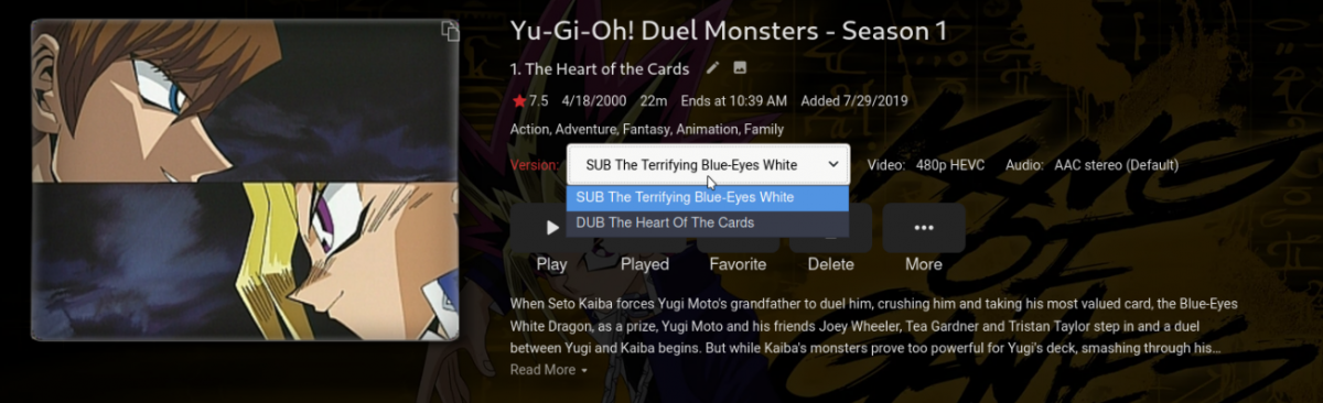

negativzeroe 80 Posted April 27, 2020 Author Posted April 27, 2020 (edited) I reproduced your issue. The problem is the version picker dropdown alphabetizes the list by title. Your titles vary for the same episode so you're never going to get the results you want. You have two options. Standardize your titles to either the English episode name or the English translation of the Japanese episode name. If the SUB and DUB versions have the same name, other than the version string after the hyphen then this wouldn't be an issue. That is what I'm saying though, I've done this. Literally renamed 1x01 - Dub, 1x01 - Sub. Currently I have 1x01 - DUB title, 1x01 - SUB Title so it should prioritize DUB based on the fact that D comes before S. One episode had DUB on top, another episode has SUB on top. It's not respecting the alphabetical versioning. Luke said before that it prioritizes the "video quality" so that it would select the better stream, but since I have the quality on the same preset it doesn't know what to do so it's just flipping a coin. Edited April 27, 2020 by negativzeroe

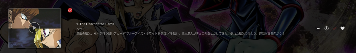

negativzeroe 80 Posted April 27, 2020 Author Posted April 27, 2020 (edited) If they're that different I think this is a MUCH better choice. Keep them as separate series entirely. I tried this but one of them kept going back to the non-duel monsters show (season 0) and would not re-identify as duel monsters. Also it looks janky, it would be much more polished if the sorting worked. It seems to in the movies section: Funny thing is, look at the previous screenshots in post 21 and DUB is actually on top for S01E01..... Tried numbering as well. 1x01.1.dub.mkv, 1x01.2.sub.mkv - based purely on subitle number hoping it would work but it didn't. Edited April 27, 2020 by negativzeroe
Deathsquirrel 745 Posted April 27, 2020 Posted April 27, 2020 That is what I'm saying though, I've done this. Literally renamed 1x01 - Dub, 1x01 - Sub. Currently I have 1x01 - DUB title, 1x01 - SUB Title so it should prioritize DUB based on the fact that D comes before S. One episode had DUB on top, another episode has SUB on top. It's not respecting the alphabetical versioning. Luke said before that it prioritizes the "video quality" so that it would select the better stream, but since I have the quality on the same preset it doesn't know what to do so it's just flipping a coin. I can't reproduce this but since I'm only simulating your setup, that makes sense. If Emby is picking the best quality it's probably something like highest displayable bitrates. That wouldn't work well in this scenario. Barring a major change in how this function works, I don't expect the multi-version feature to meet your needs.
negativzeroe 80 Posted April 27, 2020 Author Posted April 27, 2020 (edited) I can't reproduce this but since I'm only simulating your setup, that makes sense. If Emby is picking the best quality it's probably something like highest displayable bitrates. That wouldn't work well in this scenario. Barring a major change in how this function works, I don't expect the multi-version feature to meet your needs. Right but my problem is that this IS a problem, it's being treated like it's just how it works and that is that, but the way it works is non-consistent. Let me use the actual wiki's entry to elaborate: Multi-Version Episode Multi-Version Episodes are best using the following format: show name - S01E01 - Display Name 1.ext show name - S01E01 - Display Name 2.ext For example: Star Trek, The Next Generation - S01E01 - Original Broadcast.mkv Star Trek, The Next Generation - S01E01 - Digital Remix.mkv anything following the "-" (dash) up to the file extension will be used in the drop down version selector in your Emby client. In this case the two versions show in the interface will be "Original Broadcast" & "Digital Remix". So if I were to binge, The Next Generation, assuming they are of the same quality, it would just randomly play Original Broadcast or Digital Remix with no rhyme or reason. There has got to be some sort of prioritization other than quality - assuming a person rips a blu ray using makeMKV then passes it through a satisfactory h264/5 preset then the issue will continue to surface. Edited April 27, 2020 by negativzeroe

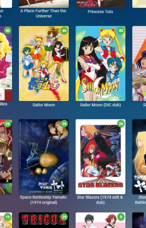

pwhodges 2028 Posted April 27, 2020 Posted April 27, 2020 I tried this but one of them kept going back to the non-duel monsters show (season 0) and would not re-identify as duel monsters. Also it looks janky, it would be much more polished if the sorting worked. Two folders works smoothly for me. This image shows two such series: In the case of Sailor Moon, the old dub was recognised by TVDB as the same as original, so I had to copy the metadata manually to the correct episodes (well, that's not how I did it, but it will do as a description), and I chose a different primary image to distinguish them. The other version has both the Japanese and the later English dub soundtracks. In the case of Space Battleship Yamato / Star Blazers (the dub was renamed as well as being edited) I found that TMBD had separate descriptions (TVDB used to have but has lost the one for the edited dub version), so I forced identification that way. Paul 2
