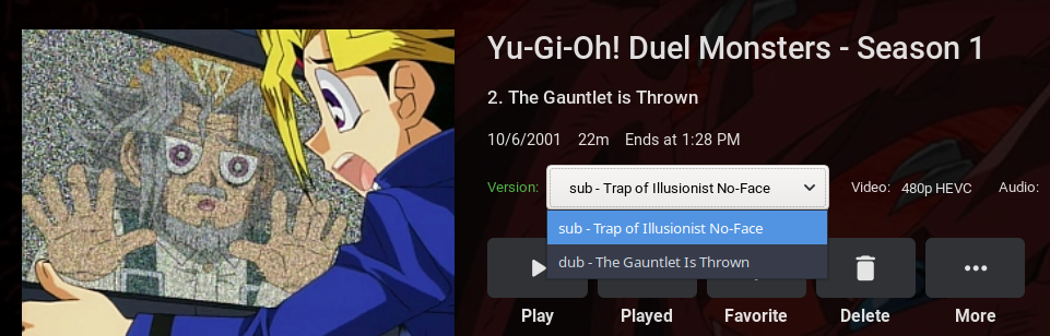

negativzeroe 80 Posted September 15, 2019 Posted September 15, 2019 Hey all, wondering if I could get some help. I have two copies of Yugioh Duel Monsters, one with Japanese audio one with English. I cannot mux to dual audio due to differences in time and censorship by 4Kids. So I have the entire show twice in two files for each episode. Now they have different names and I'm trying to preserve that but if I do "1x01 - dub - Title" and "1x01 - sub - Title" I would figure that dub being alphabetically before sub would make it the default on all episodes but it doesn't. Plenty of them make sub default, and it's a mix, so beyond making two entirely separate directories at the TV Show level, I'm not sure what else to try. I've also tried "Title.sub.ext" "Title - sub.ext" It's just a crapshoot as to what will be default.

negativzeroe 80 Posted September 18, 2019 Author Posted September 18, 2019 The problem is if both files are equally efficient at playback (same container, video codec, audio codec, bitrate...) which one is chosen as default? @@Lonald ^ This. Even name does not help, I have it set up as sub and dub so one would assume that D takes precedence over S alphabetically, but as my attachments above show, it legit has dub as preferred in one episode and sub in another.
Luke 42213 Posted September 18, 2019 Posted September 18, 2019 The naming will not impact which one is selected by default. The default is chosen based on which one will be most efficient, taking all possible app and server settings into account.

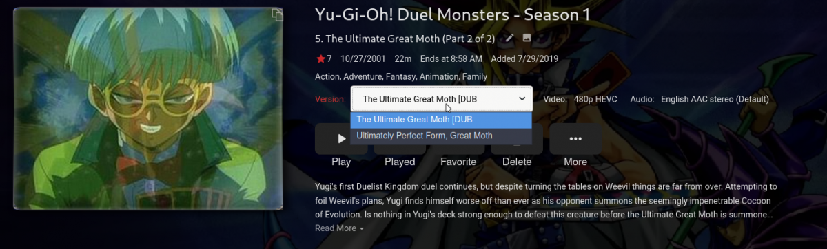

negativzeroe 80 Posted April 27, 2020 Author Posted April 27, 2020 (edited) So two things to note on this. First, why are your dub/sub rips split? It's just a different audio track and that can be done in a single file. Merge these together to save significant space. Second, I don't have this issue in the cases where I do have two copies of a show. For example I have: \\SERVER\SHARE\TV\I Dream of Jeannie\Season 01\I Dream of Jeannie S01E01 [Colorized].mkv \\SERVER\SHARE\TV\I Dream of Jeannie\Season 01\I Dream of Jeannie S01E01.mkv \\SERVER\SHARE\TV\I Dream of Jeannie\Season 01\I Dream of Jeannie S01E02 [Colorized].mkv \\SERVER\SHARE\TV\I Dream of Jeannie\Season 01\I Dream of Jeannie S01E02.mkv Those episodes consistently show up in all my clients in the same order. It defaults to the colorized version. This may be something you can address with naming changes or it's possible I'm just lucky, though it's 100% consistent for me across this season. To answer your first question, this show was heavily censored in the US, so the video tracks and even time frame are two different items in most episodes. Believe me I wish it was that easy... To your second point. I guess I'll try brackets, maybe putting it only on one will resolve because I'm pretty sure I had (DUB) and (SUB) suffixes at one point. EDIT wait that won't work because of the different titles. EDIT well I guess it's worth a shot, been dealing with this show for several years now might as well try. EDIT nope. EDIT renaming like you have as Title NUM [DUB] and nothing after the NUM on sub doesn't resolve either. Edited April 27, 2020 by negativzeroe
Deathsquirrel 745 Posted April 27, 2020 Posted April 27, 2020 I tested this creating a Spanish version of a show so I had: \\SERVER\SHARE\TV\I Dream of Jeannie\Season 02\I Dream of Jeannie S02E01 Feliz aniversario - [spanish Sub].mkv \\SERVER\SHARE\TV\I Dream of Jeannie\Season 02\I Dream of Jeannie S02E01 Happy Anniversary - [English Dub].mkv \\SERVER\SHARE\TV\I Dream of Jeannie\Season 02\I Dream of Jeannie S02E02 Always on Sunday - [English Dub].mkv \\SERVER\SHARE\TV\I Dream of Jeannie\Season 02\I Dream of Jeannie S02E02 Siempre el domingo - [spanish Sub].mkv I reproduced your issue. The problem is the version picker dropdown alphabetizes the list by title. Your titles vary for the same episode so you're never going to get the results you want. You have two options. Standardize your titles to either the English episode name or the English translation of the Japanese episode name. If the SUB and DUB versions have the same name, other than the version string after the hyphen then this wouldn't be an issue. Note that removing the title from your file names would also work. Then the version picker dropdown shows something like S01E01 SUB and S01E01 DUB and the order is consistent as in my earlier test. Submit a feature request to change the existing client behavior. You'd need to request that the version picker drop-down should be alphabetical but only sort on the text after the hyphen that denotes the version description.
