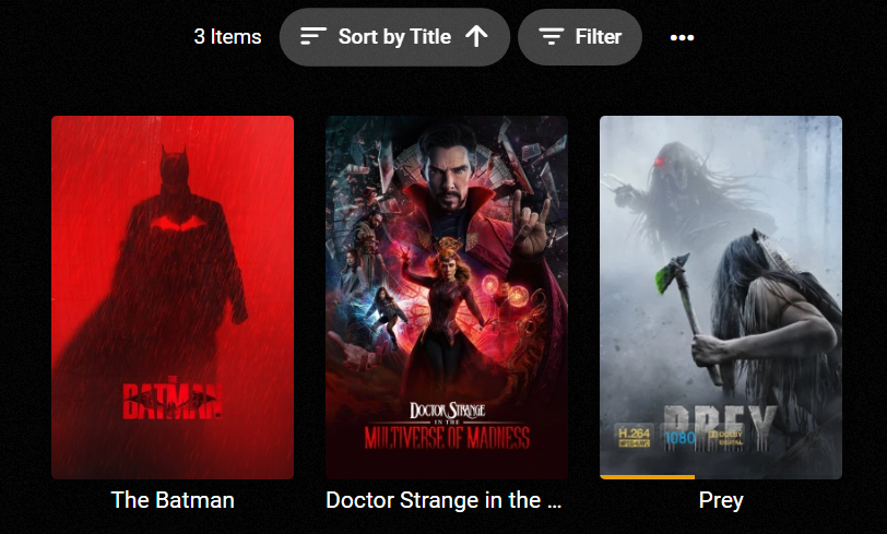

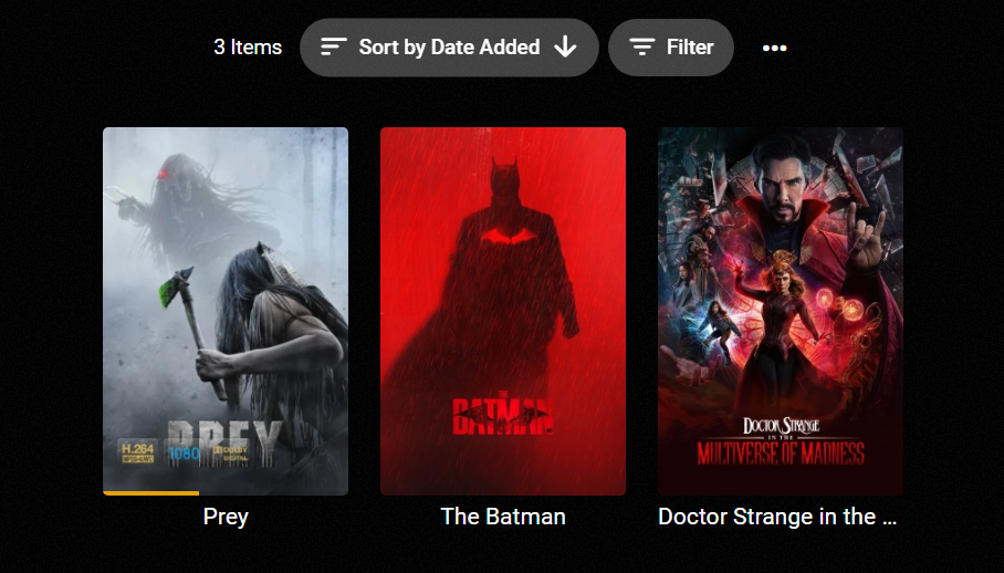

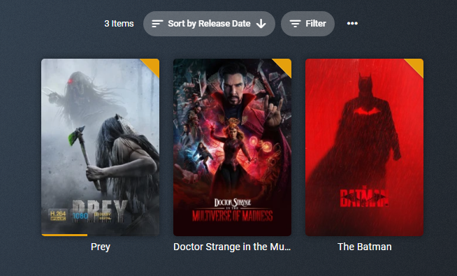

Happy2Play 9812 Posted September 20, 2022 Posted September 20, 2022 Not sure what controls sort order in TV horizontal view but appears to be Title instead of Release Date. Release date
chef 3811 Posted September 20, 2022 Posted September 20, 2022 12 minutes ago, Happy2Play said: Not sure what controls sort order in TV horizontal view but appears to be Title instead of Release Date. Release date Actually, I'm a bit concerned that it is actually DateCreated, and that by adding them to the channel a certain way, makes them appear on the home screen in that order. That first image is from the home screen?
Happy2Play 9812 Posted September 20, 2022 Posted September 20, 2022 Just now, chef said: Actually, I'm a bit concerned that it is actually DateCreated, and that by adding them to the channel a certain way, makes them appear on the home screen in that order. That first image is from the home screen? Yes as that is TV Horizontal view instead of our Vertical view as @ONYX MEDIAshowed on previous page. But DateAdded is a different order also. Only vertical view give options to sort so can only guess it is coded for Horizontal view. Title 1
chef 3811 Posted September 20, 2022 Posted September 20, 2022 Just now, Happy2Play said: Yes as that is TV Horizontal view instead of our Vertical view as @ONYX MEDIAshowed on previous page. But DateAdded is a different order also. Only vertical view give options to sort so can only guess it is coded for Horizontal view. Title which client is that, when you refer to TV Horizontal view? WebApp?
Happy2Play 9812 Posted September 20, 2022 Posted September 20, 2022 Just now, chef said: which client is that, when you refer to TV Horizontal view? WebApp? Web client go to Display change display mode to TV, then Home Screen and change TV mode Home Screen to Horizontal. My have to refresh or naviage pages to force display change.

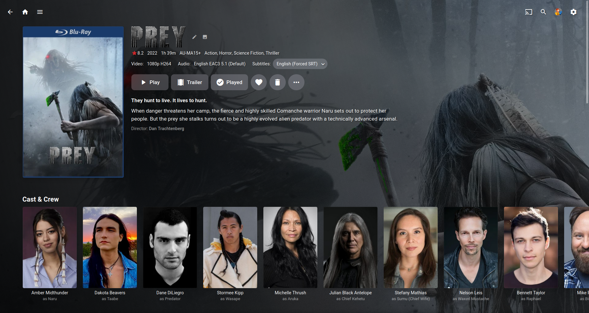

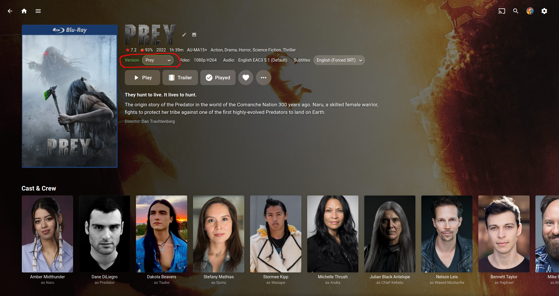

Junglejim 385 Posted September 20, 2022 Posted September 20, 2022 Nice work mate, working great here. One thing I have noticed is if I enter the movie details from the New releases I get a version drop down option (name of movie/undefined).. Maybe that has something to do with the conversation in the previous posts? But hey it works! Really looking forward to the Top Picks, Paypal is ready to go.. 1 1
chef 3811 Posted September 20, 2022 Posted September 20, 2022 (edited) 1 hour ago, Junglejim said: Nice work mate, working great here. One thing I have noticed is if I enter the movie details from the New releases I get a version drop down option (name of movie/undefined).. Maybe that has something to do with the conversation in the previous posts? But hey it works! Really looking forward to the Top Picks, Paypal is ready to go.. Yes I also see undefined. Does Prey have two media streams? ie. 1080p and 2160p version in your library? Edit: actually having multiple media sources isnt the issue. But, this does bring up two questions. What is causing undefined?... And why are media items with two media sources (ie. 1080p and 2160p) not showing both? Edited September 20, 2022 by chef
chef 3811 Posted September 20, 2022 Posted September 20, 2022 (edited) There are somethings I don't quite get. There is the MediaStream, and there is the MediaSource. In channels the property is MediaSource (which I gather is exactly what it sounds like... The source of the media stream). There is an extension method used to convert MediaStreams to MediaSources. But, I can't quite figure out how to add multiple media streams (ie. 1080p and 2160p) to the MediaSources property... And I have tried. For example when you have a 1080p version of a movie in your library, and then you add a 2160p version, emby assigns each version an id and its own entry in the library.db. While iterating the library query result, and creating channel items each of those entries (versions) of the movie will appear in the query. When Prey 1080p appears during the iteration, we add it to the channel, and point it's MediaSource to the 1080p file. When Prey 2160p appears during the iteration, we add a new MediaSource entry to the existing channel item for Prey. That logic seems like it should work... Prey should then have two MediaSources, 1080p, and 2160p. It does not. What is also strange is that the channel item will create an "undefined" MediaSource. At first I thought that this could be a null source being added when creating the channel. Some sort of index out of range (zero index count) happening when adding sources to the channel. I don't think this is what is happening. I'm not sure what the undefined source is, or where it is coming from... Edited September 20, 2022 by chef
Junglejim 385 Posted September 20, 2022 Posted September 20, 2022 10 hours ago, chef said: Yes I also see undefined. Does Prey have two media streams? ie. 1080p and 2160p version in your library? Edit: actually having multiple media sources isnt the issue. But, this does bring up two questions. What is causing undefined?... And why are media items with two media sources (ie. 1080p and 2160p) not showing both? Hi mate, no I only have one version of Prey (1080). Not sure why it shows 2 from New releases, if I go to details from the main movie lib or latest movies I don't get 2 versions. Like so..
chef 3811 Posted September 21, 2022 Posted September 21, 2022 Wierd... Now I'm even more confused. On the kids movie channel, which has pretty close to the exact same code as this channel. There is no "undefined" version. So... Why, I wonder, is that?
Happy2Play 9812 Posted September 21, 2022 Posted September 21, 2022 True as the only difference really should be Parental rating vs Premiere date.
