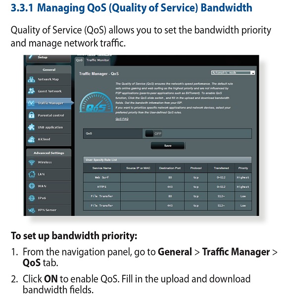

Guest asrequested Posted September 2, 2019 Posted September 2, 2019 What do you have in this section? Have you checked your router configuration? https://www.asus.com/us/Networking/RTAC87U/HelpDesk_Manual/

BillyBob1 1 Posted September 2, 2019 Author Posted September 2, 2019 I just deactivated QoS and still no change. I just don't under stand I pulled up my Android app on my Pixel 3 sitting next to my router and tried watching Ballers direct play and it still pauses every 30 seconds or so. oh well.

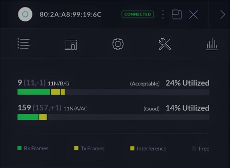

Guest asrequested Posted September 2, 2019 Posted September 2, 2019 That's what's nice about the Unifi stuff. It tells you everything.
