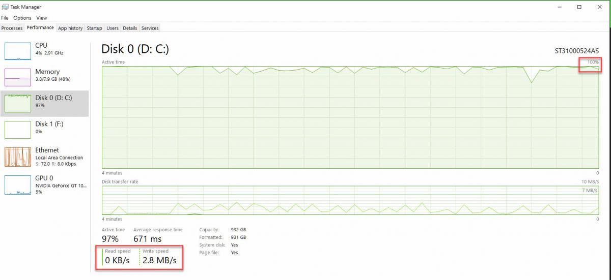

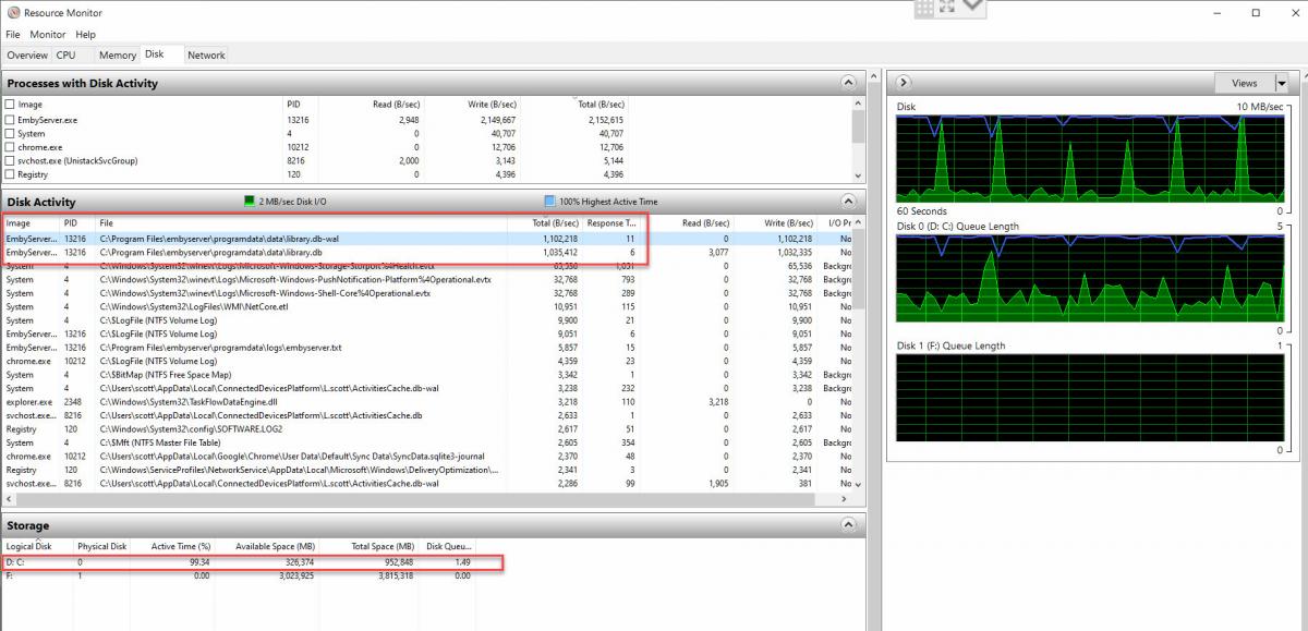

SonnyMN 1 Posted October 17, 2019 Author Posted October 17, 2019 (edited) I upgraded home PC to windows 10 with latest updates. Things got a little better, but figured out the performance issue with disk I/O is only happening when the scheduled task gets the Emby Guide Data ... which runs for 28-30 minutes and the disk is 100% utilized with embyserver hogging the disk. I can recreate the issue by selecting the schedule task in emby manager and running it ... even though it seems to be successful ... that task runs about once an hour even though it is set to run once every 12 hours. Logs attached ... restarted embyserver that cleaned out the old log, log debug was enabled but does not seem to add anything additional for the emby schedule GET. Screenshots also attached that shows that even though the disk I/O volume is not very heavy (under 3MB/sec and this disk can handle far more) but the embyserver process is accessing/writing to the library.db* files which is the cause ... stopping the get of the emby schedule resolves the performance issue and the disk i/o goes way down. I have seen 5 shows recording at the same time and I watch another recorded show ... with no issues ... disk i/o above 25MB/sec and disk % active is 20-30%. Only when the emby scheduler gets the schedule data from emby source is there a problem. The emby scheduled task is configured for once every 12 hours but I can see that it is running at least once an hour and preventing me from being able to use emby effectively. I deleted the scheduled task in emby and added two separate tasks: run at 1am, run at 1pm (daily) this provides a fixed, known daily time when the task runs. will see if this helps. embyserver.txt Edited October 17, 2019 by SonnyMN
