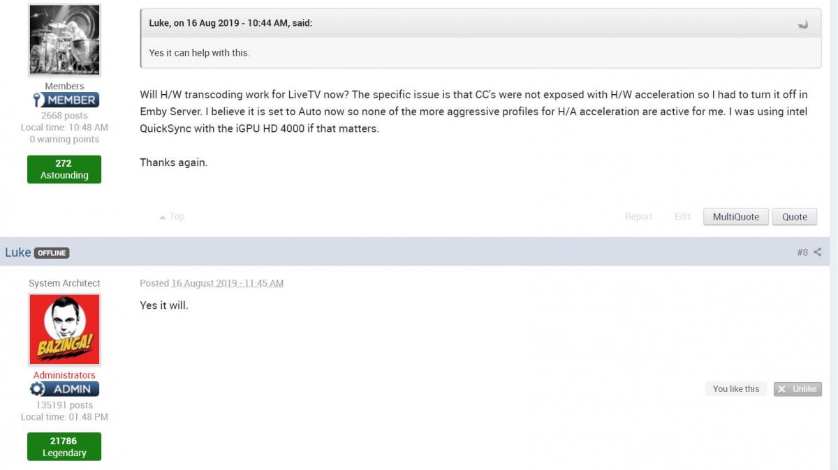

Sammy 791 Posted August 27, 2019 Author Posted August 27, 2019 https://emby.media/community/index.php?/topic/76584-do-i-need-a-gpu/?p=776992 I went with this. Hopefully it can be remedied soon. Thanks.
Guest asrequested Posted August 27, 2019 Posted August 27, 2019 It's a condition of how CCs are added to the video. As far as I know, there is no way around it.
