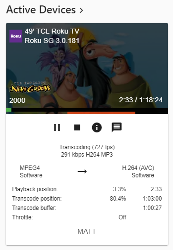

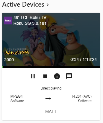

bizarro252 17 Posted August 29, 2019 Author Posted August 29, 2019 Hi @@Luke Watching in the server GUI while playing this same file again today to see what it was doing, very weird behavior - it will start off transcoding and show the details but it will flip over to showing "direct playing" and then back to transcoding. It seems to skip while this flipping back and forth is happening (picture freezes, audio continues, picture unfreezes but is then out of sync with audio for a bit before it all syncs back up). Perhaps this helps, seems to be specific to .avi and seems to be related to the server not transcoding correctly/consistently. I can reproduce this easily so let me know if you need anything else specific. This is on stable 4.2.1.0 Thanks!

bizarro252 17 Posted September 3, 2019 Author Posted September 3, 2019 Hi Luke, Just checked, I played in the web app just fine, also behavior within the server admin GUI was also 'normal' showing that it is transcoding, not bouncing back and forth between transcoding and direct playing like it does when streaming to Roku, Thanks
speechles 2062 Posted September 3, 2019 Posted September 3, 2019 What does stats for nerds say while the Roku is playing? That will show what is actually happening. It should not create individual sessions when it does playback recovery. It should kill the old session and respawn the same identical session with new media playing. It sends the appropriate signals to the server. But maybe it is confuse the audio? Maybe the audio is where the confusion lies possibly? Does stats for nerds say the video is direct streaming but the audio is transcoding possibly?

speechles 2062 Posted September 13, 2019 Posted September 13, 2019 (edited) It looks like the video is transcoding according to the stats for nerds. The bitrate at first jumps around. The transcoding progress never grows. The odd part is right before your loop back it appears the transcoding information stops being part of the session information. That is why transcoding progress suddenly jumps to 100% as the other transcoding fields go blank. The app believes when this happens transcoding is complete because it has stopped. @@Luke Do you know what causes this? Edited September 13, 2019 by speechles
