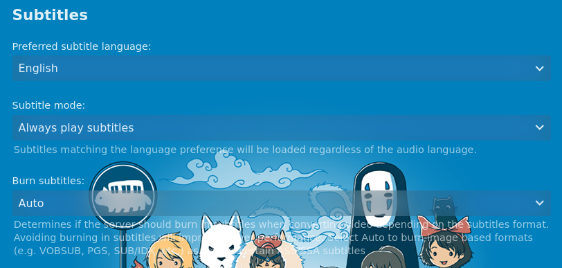

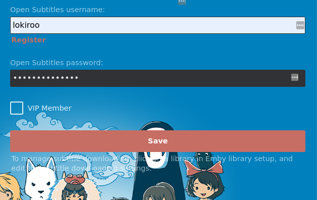

lokiroo 0 Posted August 27, 2019 Author Posted August 27, 2019 (edited) I have attached the log below of the the most recent video I attempted to play from the WebPlayer. Here is also a screenshot of what the inside of the folder looks like eon my server as well as the setting I have enabled for my profile and server. Despite all of this I am still unable to view subs on both my Roku and in the browser. ffmpeg-remux-a9263e2e-813d-452c-9b57-26feaa1340a9_1.txt Edited August 27, 2019 by lokiroo
