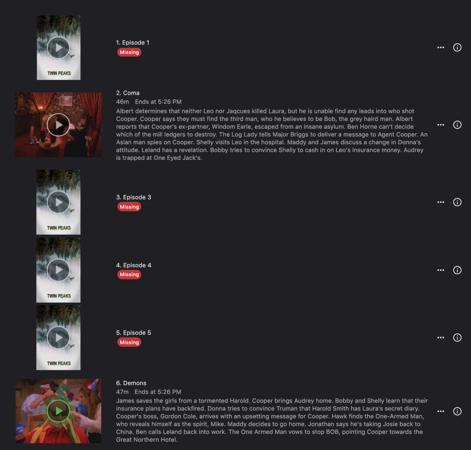

vash265 0 Posted August 26, 2019 Author Posted August 26, 2019 Yea it's just something we're going to have to wait on. Thanks for the feedback. I will say that it's completely inconsistent. For example, I have season 3 of twin peaks stored on one harddrive, and seasons 1 and 2 stored on another. Season 3 was added to the library first, and all episodes show up. Seasons 1 and 2 were added more recently, and this is what the lineup for season 2 (for example) looks like: There's no discernable difference between any of the video files, and all of the nfo files for all of the episodes in season 2 are present (meaning they were scraped). Is the behavior with .net just completely unpredictable or is there something else going on?
Luke 42246 Posted August 26, 2019 Posted August 26, 2019 It is unpredictable. There is actually some support for symlinks, but it's not complete and they don't always get followed automatically depending on what file API's are being used.
