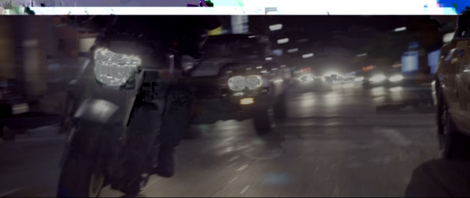

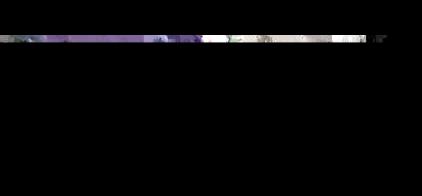

sutt359 2 Posted August 21, 2019 Posted August 21, 2019 (edited) Hi Guys Been using emby for a very long time but thought i would do some upgrades to my system for 4k movies. Ive installed a Nvidia Quadro p600 for hardware transcoding which works a treat on 1080/720p but when it comes to 4k, i get artifcting and the image brakes up. I set emby back to CPU and it works fine converting 4k down 1080/720 When im home i can watch 4k direct play just fine, but when out and about i can watch where i left off at a lower quality. This is going via firefox or edge and the windows 10 app. My system Hp Microserver Gen8 Windows server 2019 CPU Xeon E3-1260L 16GB ram GPU Nvidia Quadro p600 2gb Most recent from Nv Nvidia Version: R430 U5 (431.70) WHQL Release Date: 2019.7.29 Edited August 22, 2019 by sutt359

softworkz 5130 Posted August 24, 2019 Posted August 24, 2019 (edited) Is that a Nvidia or Emby issue? First, I'd say that it's not a matter of FullHD vs. 4k It's rather an issue of decoding HEVC 10bit video with Nvidia Quadro. Which makes it a known issue. The good news is that we do have a Quadro in the lab for testing now, but it will take a little more time until we get to it. The instant/preliminary solutions for you are either: DX11VA NVIDIA Quadro P600 - H.265 (HEVC)(try the DXVA Decoder) ... or ... Stick to CPU decoding You should activate throttling in both cases. The fact that you're seeing 100% CPU doesn't necessarily mean that your CPU is too weak or not suitable for the job. It could be, but we'd need to see an ffmpeg log for this case to be sure. Maybe the CPU is just slower than the hardware encoder. That's no problem as long as it's fast enough to decode at 1.0x speed. Edited August 24, 2019 by softworkz
