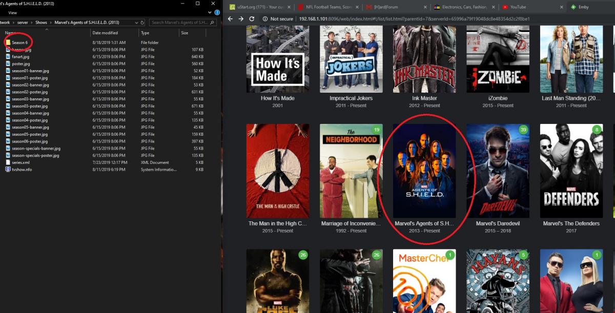

rigo8582 16 Posted August 22, 2019 Author Posted August 22, 2019 (edited) Okay my issue was "stubs" don't work in that structure. Once I gave them a video extension, that structure was identified without issue. @@rigo8582 Can you go over a specific example. Actually if I understand it correctly you basically create a empty folder scenario when your remove the season folder. So yes it is the expected behavior of the Series no longer being visible within Emby. Only visible in the library folders tab because Emby basically forgets it is a Series folder do to no media. I can create a folder "Altered Carbon" for example and do a scan. It will not identify as a series, and will only show up in the "Folders" view. If I put a folder in it like "Season 1" and that folder be empty. Then do a scan it will then identify as a series and download all the metadata and images. If I go back and delete "Season 1" folder within "Altered Carbon". Scan the library, the series is no longer identified and goes to only being viewed in the "Folders View". I put some screenshots I just did. I showed a Folder Agents of Shield with a Season 6 folder. How it shows in my library which is correct. Then deleted Season 6 and did a library scan. You will see Agents of Shield is no longer in my library. Then I show that Agents of Shield is showing up in the folders. Edited August 22, 2019 by rigo8582

Luke 42213 Posted August 22, 2019 Posted August 22, 2019 Then deleted Season 6 and did a library scan. You will see Agents of Shield is no longer in my library. Then I show that Agents of Shield is showing up in the folders. Looks like expected behavior. You have no content inside your agents of shield folder.
