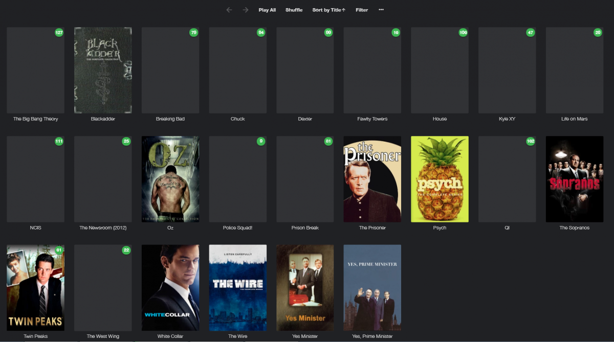

crusher11 1344 Posted August 18, 2019 Posted August 18, 2019 A ton of TV images and quite a few movie images (posters, thumbnails, etc) aren't loading. They're still present on the server, but don't display in the apps.

crusher11 1344 Posted August 18, 2019 Author Posted August 18, 2019 (edited) Not sure how much more specific I can be. I keep seeing this. It's always the same images missing. Just started randomly today, occurs on all devices both remotely and locally. Edited August 18, 2019 by crusher11

Solution crusher11 1344 Posted August 18, 2019 Author Solution Posted August 18, 2019 Uninstalling cover art seems to have fixed the problem. 1
crusher11 1344 Posted August 18, 2019 Author Posted August 18, 2019 I'm not sure how that solves my problem though? "Get rid of CoverArt" isn't much of a solution. I tried reinstalling it and exactly the same images failed as failed the first time. So it's not even a temporary glitch fixable by an uninstall/reinstall.
Happy2Play 9840 Posted August 18, 2019 Posted August 18, 2019 Is this a Windows 7 issue or a specific configuration in CoverArt as there are obvious image processing errors? Or corrupt images in "\cache\images\enhanced-images\"? 2019-08-19 04:09:41.723 Error ImageProcessor: Error encoding image *** Error Report *** Version: 4.2.1.0 Command line: C:\Users\myname\AppData\Roaming\Emby-Server\system\EmbyServer.dll Operating system: Microsoft Windows NT 6.1.7601 Service Pack 1 64-Bit OS: True 64-Bit Process: True User Interactive: True Runtime: file:///C:/Users/myname/AppData/Roaming/Emby-Server/system/System.Private.CoreLib.dll Processor count: 8 Program data path: C:\Users\myname\AppData\Roaming\Emby-Server\programdata Application directory: C:\Users\myname\AppData\Roaming\Emby-Server\system System.Exception: System.Exception: SKCodec had an error reading C:\Users\myname\AppData\Roaming\Emby-Server\programdata\cache\images\enhanced-images\e\ea1bfc996f93b69c890cbdaaedb3c041.jpg at Emby.Drawing.Skia.SkiaEncoder.EncodeImage(String inputPath, String outputPath, Boolean autoOrient, Nullable`1 orientation, Int32 quality, ImageProcessingOptions options, ImageFormat selectedOutputFormat) at Emby.Drawing.ImageProcessor.ProcessImage(ImageProcessingOptions options, CancellationToken cancellationToken) Source: Emby.Drawing.Skia TargetSite: System.String EncodeImage(System.String, System.String, Boolean, System.Nullable`1[MediaBrowser.Model.Drawing.ImageOrientation], Int32, MediaBrowser.Controller.Drawing.ImageProcessingOptions, MediaBrowser.Model.Drawing.ImageFormat)
crusher11 1344 Posted August 18, 2019 Author Posted August 18, 2019 FWIW all my TV series are set to "plain", so they shouldn't need to have anything done to them. Within my movies it doesn't seem to apply to any specific CoverArt treatment either.
Happy2Play 9840 Posted August 18, 2019 Posted August 18, 2019 FWIW all my TV series are set to "plain", so they shouldn't need to have anything done to them. Within my movies it doesn't seem to apply to any specific CoverArt treatment either. Plain still applies a overlay so you can have overlay indicators. So Plain is not the same as Ignore.
crusher11 1344 Posted August 18, 2019 Author Posted August 18, 2019 Changing TV to Plain fixes TV. Movies are still an issue though, and seemingly just as random. For example Alien has no image, but Aliens, Alien 3 and Alien Resurrection work just fine. They're all ripped from the same BD set.
crusher11 1344 Posted August 18, 2019 Author Posted August 18, 2019 I just rebooted my computer, and CoverArt completely reset itself.
