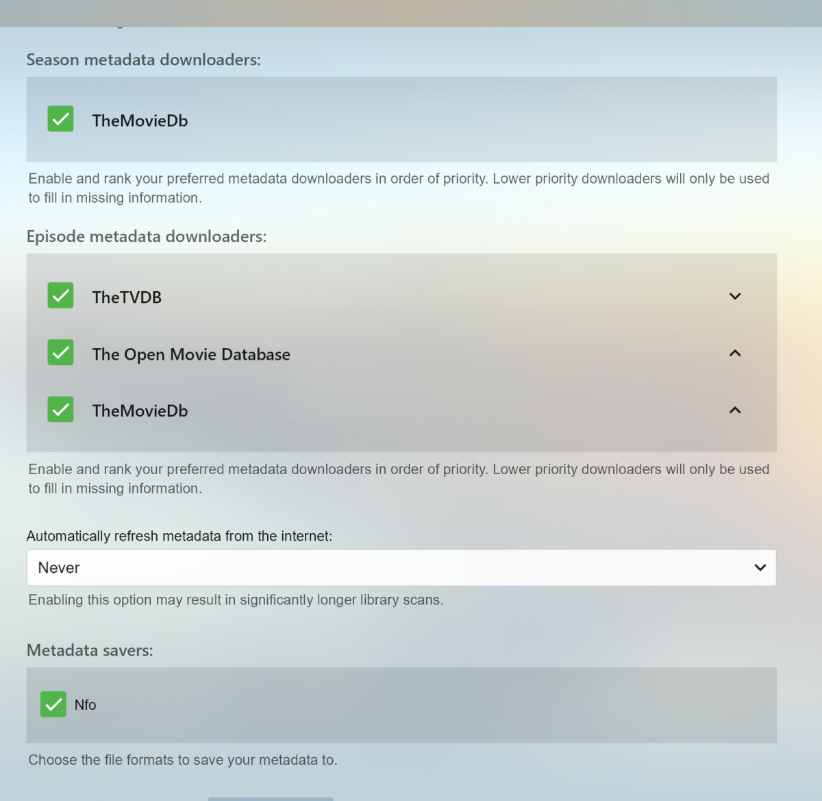

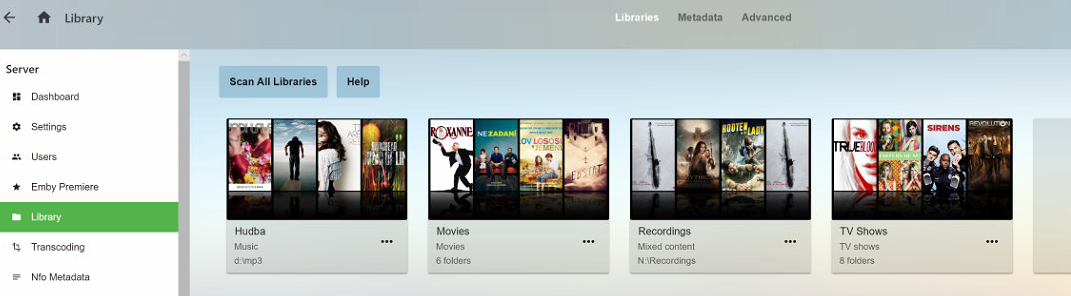

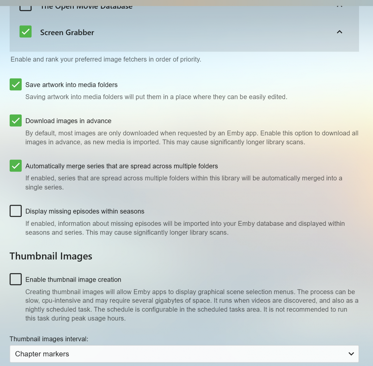

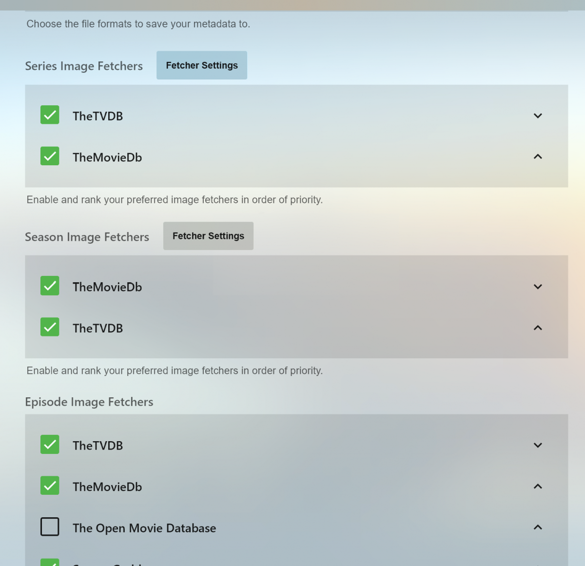

cembry 1 Posted August 16, 2019 Author Posted August 16, 2019 There are screenshots of my tv shows library setup...

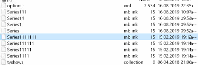

cembry 1 Posted August 17, 2019 Author Posted August 17, 2019 I was trying to add the folder T:\HDD01\Series. Media in this folder are showing in the library, but the path is not visible in the library setup. The files in the \emby-server\programdata\root\default\TV Shows folder are on the picture. They are sorted by date, four of them with yesterday date are pointing to the folder T:\HDD01\Series.
Happy2Play 9806 Posted August 17, 2019 Posted August 17, 2019 I was trying to add the folder T:\HDD01\Series. Media in this folder are showing in the library, but the path is not visible in the library setup. The files in the \emby-server\programdata\root\default\TV Shows folder are on the picture. They are sorted by date, four of them with yesterday date are pointing to the folder T:\HDD01\Series. mblink.png You will have to open these files in something like note pad and verify the linked path in the file but as I suspected you have additional links for the same paths you have already shown for your attached folders. Since all the folders have the same name that is reason for all the 1's appended to each link. Technically there should only be 4 mblinks not 8 in that folder as you only have 4 attached folders via the Library. So you can remove the entire library and do several scans so all the false links get removed or verify all the mblinks and remove the duplicates with the most appended 1's. Once you have cleaned up the duplicates then try to add the missing folder again.

cembry 1 Posted August 17, 2019 Author Posted August 17, 2019 I removed all four mblinks to the last folder added (T:\HDD01\series). Then I deleted 1111 from the names of remaining mblinks (the names were then series, series1, series11, series111) and restarted emby server. Library was showing only four folder, that was correct. Then I successfuly added the last folder. Problem solved, thank you very much for helping! I think there was running a library scan when I was adding the folder do the library. Could it be the reason the folder was not shown in the folder list?
