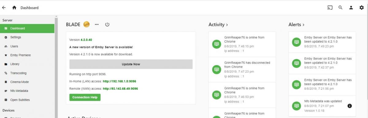

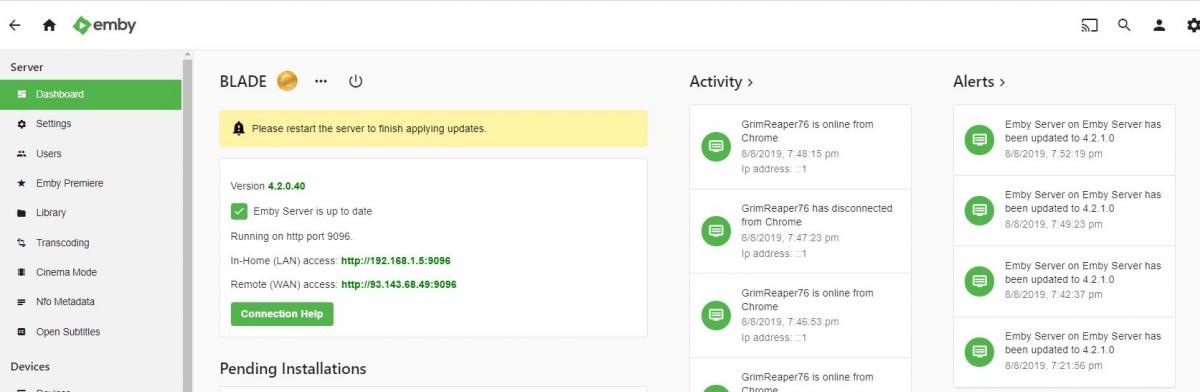

GrimReaper 4864 Posted August 8, 2019 Posted August 8, 2019 Howdy all, Running Win server 4.2.0.40, Automatic Updates are enabled, 30 minutes ago server updated to 4.2.1.0 (together with Nfo metadata plugin), server restart - and following screen appears: Hm, still on 4.2.0.40, lets update again, click Update now, get following message: Ok, restart - back to 4.2.0.40 and same Update now message (as visible from Alerts section): Few more tries, no change, here I go, Community. :/ Any advice? Cheers, Grim

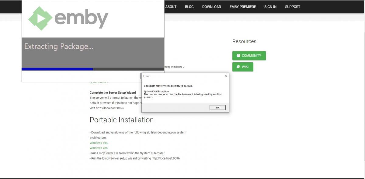

Luke 42219 Posted August 8, 2019 Posted August 8, 2019 Something must be holding a lock on the server's folder, preventing the update. Try shutting down the server, then running the installer from the website on top of your existing version. 1
Solution GrimReaper 4864 Posted August 8, 2019 Author Solution Posted August 8, 2019 Something must be holding a lock on the server's folder, preventing the update. Try shutting down the server, then running the installer from the website on top of your existing version. Thanks for quick reply, Luke. Yup, you were right, switching off server and running installer returned this: System reboot, update from Dashboard, all peachy: Thanks again. Cheers 1
