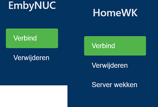

xsxavier 0 Posted August 8, 2019 Author Posted August 8, 2019 (edited) Here is the example, this one was from the windows app. Literally the option is just missing. I have tried adding the server through emby connect and also adding it by local ip. Either way it doesn't show. Edited August 8, 2019 by xsxavier

Luke 42219 Posted August 8, 2019 Posted August 8, 2019 The only thing I can think of is that server is not able to determine it's mac address information and that's why this is happening. I would try signing out and back into the app one more time. if that doesn't do it then please attach the emby server log. thanks.
xsxavier 0 Posted August 8, 2019 Author Posted August 8, 2019 Somehow after 2-3 tries of logging in/out again, it just now appeared, I thought let's check one last time and voila there it was! So I guess it's resolved, thanks!
