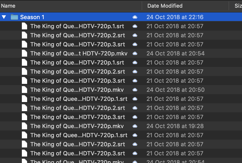

Luke 42218 Posted August 8, 2019 Posted August 8, 2019 Hi, yes can you show us the contents of the series folder? Thanks.
jburgess 13 Posted August 8, 2019 Author Posted August 8, 2019 Sure, That is constant throughout all folders. Hasn't changed either. No files added.

Happy2Play 9806 Posted August 10, 2019 Posted August 10, 2019 What is the episode naming scheme as the image hide it? Sounds like the other topics with some sort of database issue. If you move that series to a new location and create a new library, does that series work?
