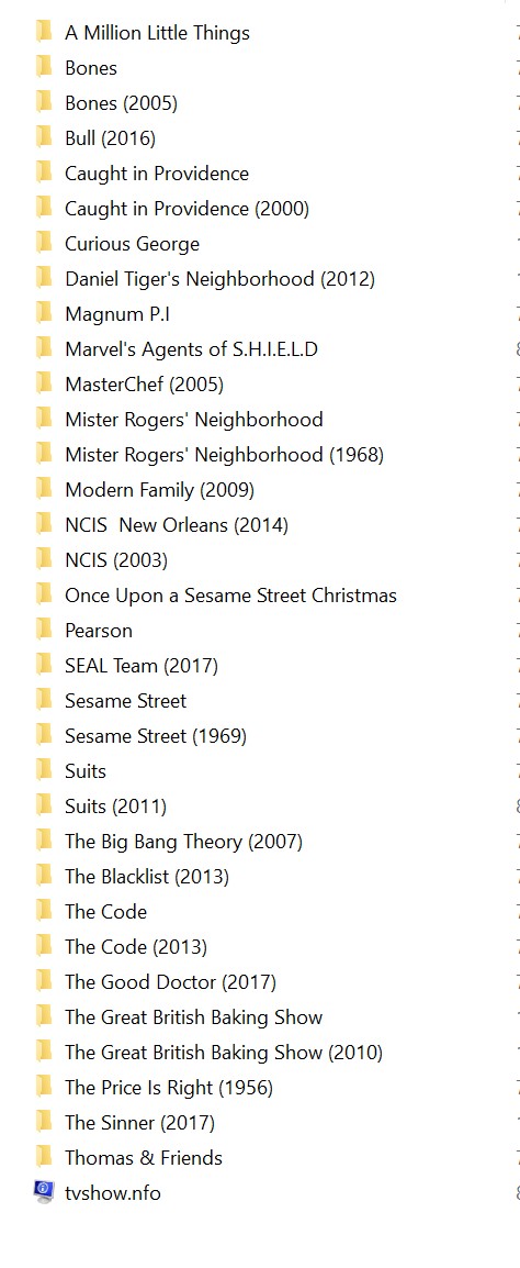

legallink 187 Posted August 8, 2019 Author Posted August 8, 2019 Nope, none. I looked at all the folders in the Recordings/Series folder, and aside from a year in parenthetical, no series has a number in it. I've attached a screen shot of the folders in Recordings/Series, and I'm not seeing any with a numerical value in the name. Note that all folders are created by the system when setting up a recording for a series and then a recording happens. I don't set up any folders in this folder.
Luke 42219 Posted August 8, 2019 Posted August 8, 2019 Well you have a tvshow.nfo file there. i would try deleting that and then running a scan.
legallink 187 Posted August 8, 2019 Author Posted August 8, 2019 Well aren't I thick. That solved it initially. Thanks @@Luke! We'll see if anything else pops up. Not sure how the tvshow.nfo got there.
