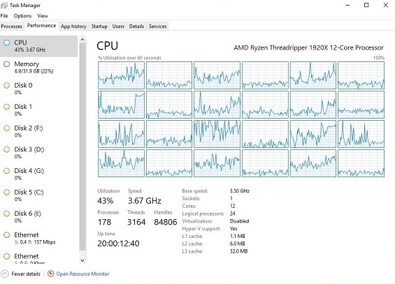

Guest asrequested Posted August 5, 2019 Posted August 5, 2019 (edited) This is what mine looks like. A high of 43% and a low of 22%. Disk IO was a high of 2% (transcode drive is an M.2 SSD) Edited August 5, 2019 by Doofus

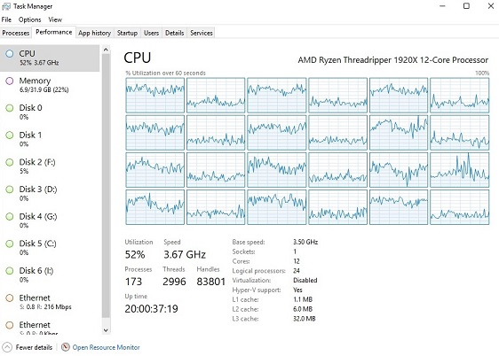

Guest asrequested Posted August 5, 2019 Posted August 5, 2019 (edited) Curiously, when transcoding while watching, it's a little faster and the activity is different. Notice the network traffic bandwidth. Edited August 5, 2019 by Doofus
