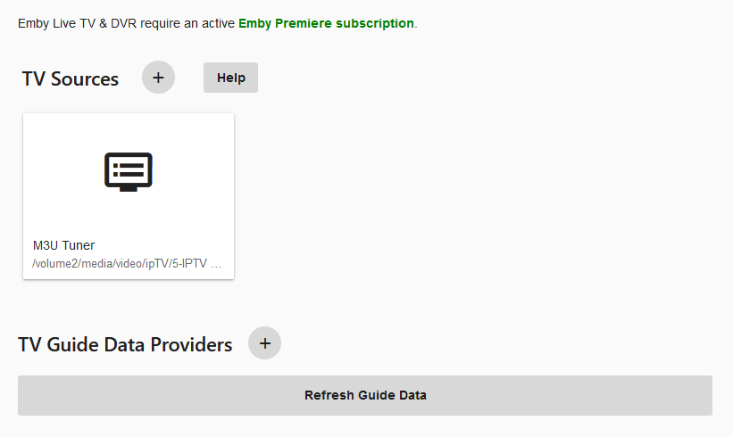

EODCrafter 181 Posted August 4, 2019 Posted August 4, 2019 (edited) The m3u is playing fine in vlc. I've tried adding the m3u list you have provided - still I do not have the Live TV option in my Emby Website nor in my Emby Theatre :-( Also, I am still not able to delete the m3u lists from the Admin Page... ?! Any Idea about this? Click on the 3 dots....delete.... Since there is no EPG with either yours or Mine, you will have to select the Channel list in Emby rather than being able to use the guide...Here's a SS.... Edited August 4, 2019 by EODCrafter
CChris 59 Posted August 4, 2019 Author Posted August 4, 2019 I do not have this section in my Emby - That's the point!Also I do not have any option to delete the whole m3u from the LiveTV Settings in the Admin Panel... ?!sorry for these dump questions... But maybe, I just look at the wrong place?

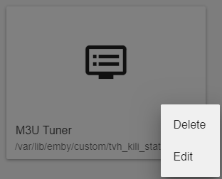

Q-Droid 1011 Posted August 4, 2019 Posted August 4, 2019 (edited) To delete tuner. If you want to use a Hauppauge tuner card in Linux then you'll need something like TVHeadend to manage the tuner card itself and then use one or more M3U links from Emby to TVH to access the streams/channels. Once configured it's as seamless as the native tuner support in Emby. Edited August 4, 2019 by Q-Droid
CChris 59 Posted August 4, 2019 Author Posted August 4, 2019 As you can see in my Screenshot above, I do not have these three dots...But thanks for the guide with adding a Hauppauge Tuner on Linux... I will have a look if I can manage this when I have a bit more time for it.
pünktchen 1411 Posted August 4, 2019 Posted August 4, 2019 I do not have this section in my Emby - That's the point! Have you checked your user settings -> allow live tv management? Also I do not have any option to delete the whole m3u from the LiveTV Settings in the Admin Panel... ?!Yes, it's a bug. You can still use delete with an other app, Android for example. 1
EODCrafter 181 Posted August 4, 2019 Posted August 4, 2019 (edited) Thanks Sry, I never thought to Mention READ the instructions first...My Bad. I thought the bug was fixed with the latest update? I see three Dots...am I losing my mind? Oh, lol that's a continuation of the long m3u name...Sry Edited August 4, 2019 by EODCrafter
