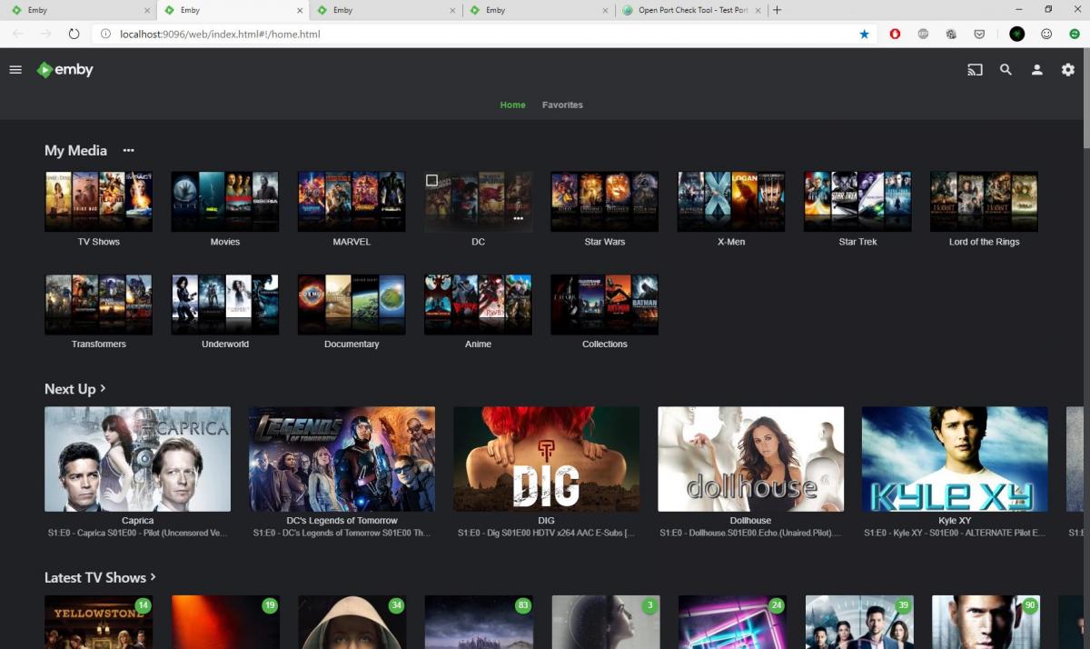

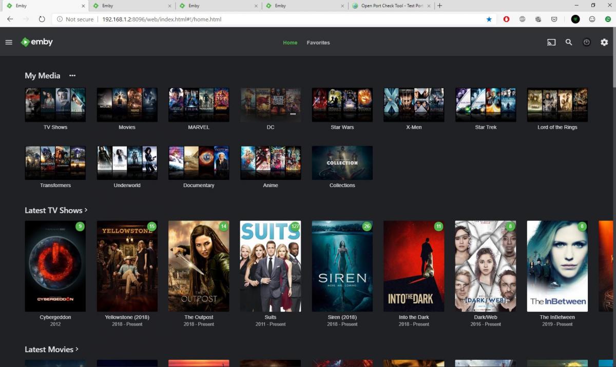

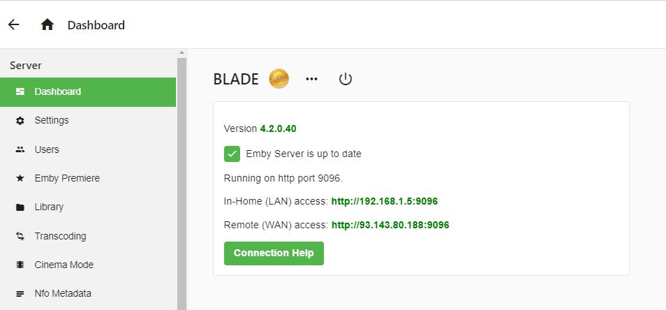

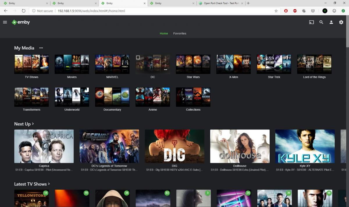

For quite some time I've been running Shield TV Android server (and been VERY happy with it, it's still my primary server). However, due to some plugins being incompatible/unavailable for the said platform, I've decided to build a Windows server for both backup and certain plugins purposes. So, latest stable 4.2.0.40 install, setup Libraries etc. - all peachy, built an independent server in no time. During that time access was only form Win10 laptop that runs same server, access from both localhost:port and IP:port.
And access to Shield server as well:
Btw, my home network setup is standard 192.168.1.x with static IPs outside of router's DHCP pool.

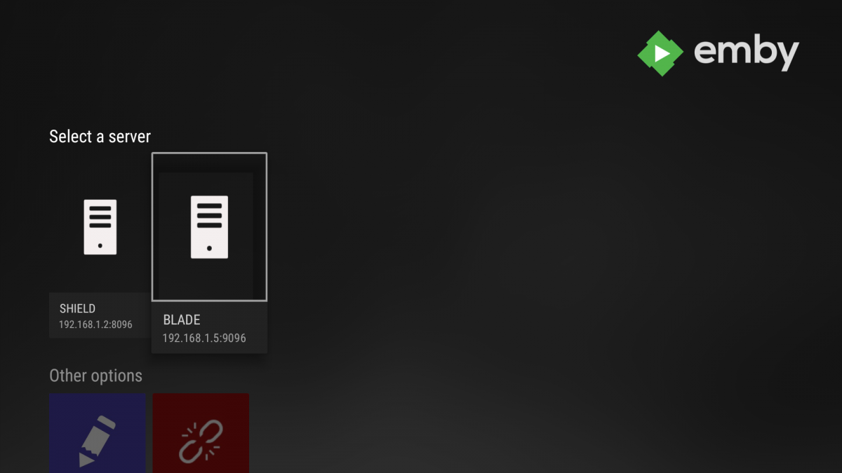

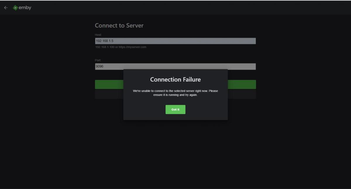

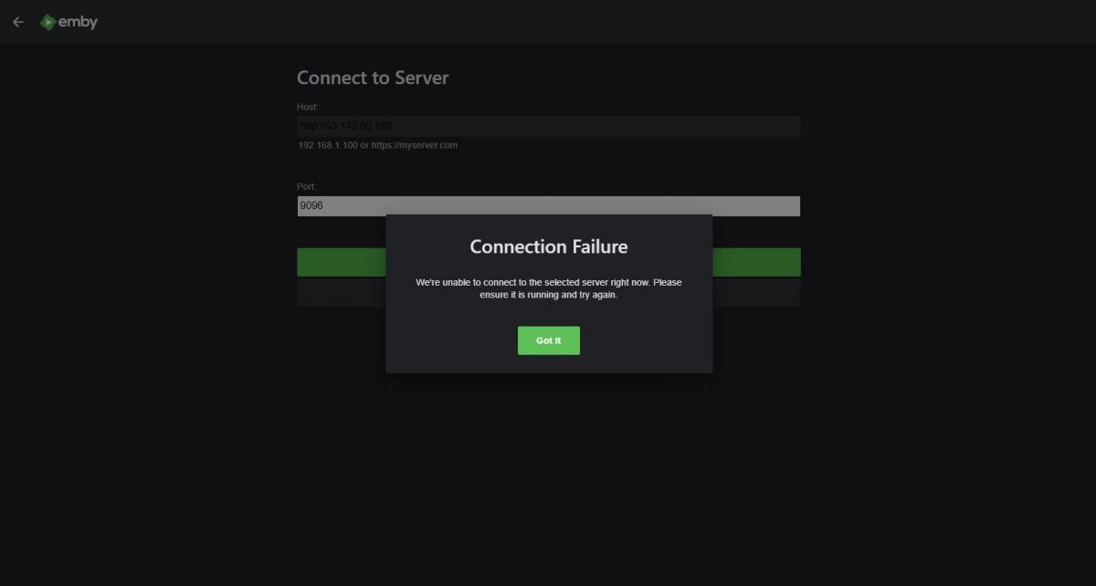

Problems arose when trying to connect to Win server from ANY other device on my LAN, it being Shield, cell phone Android App, tablet Android app or any browser on them (I'll be using shiled Android TV app as an example) - server is just unreachable.
If trying to connect to Win server form Shield - I cannot either connect or wake it, although server is up and running and accessed at the same time from laptop.

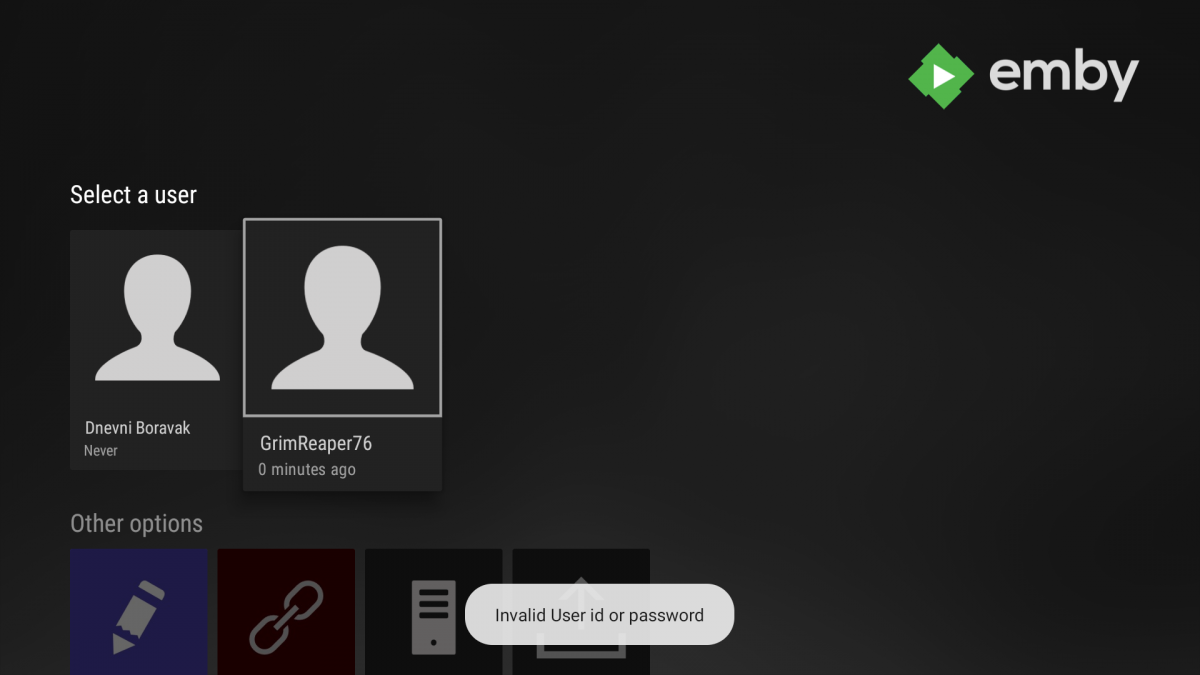

If trying Manual connection, at least I get Login screen/Users listed, but still no connection possible with the error "Invalid User ID or password" which is kinda ridiculous.

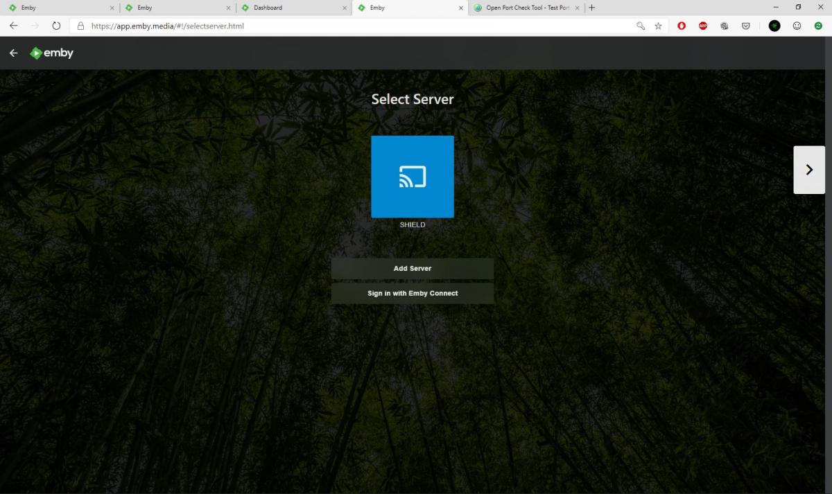

Aditionally, app.emby.media only lists Shield server.

Ok, so i removed the server, upon next Switch Server it naturally came back but with no effect, same error - cannot connect or wake.
Manual entry also yields same result, "Invalid user id or password".

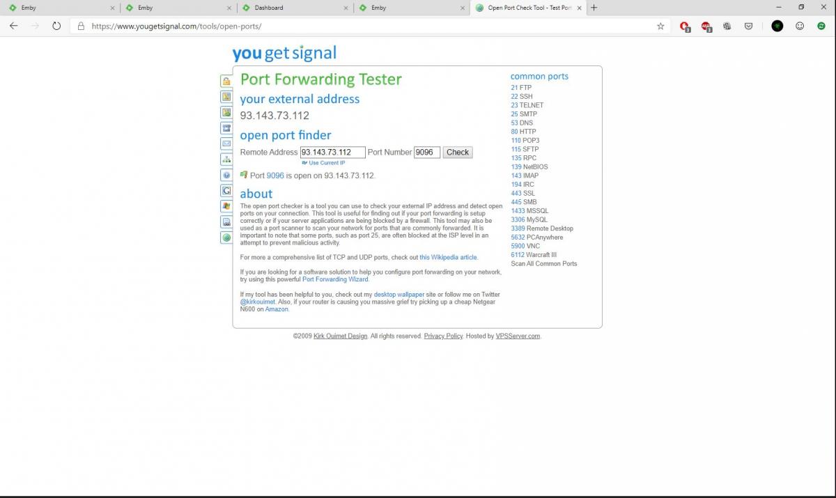

However, another issue still remains, app.emby.media still lists only Shield server bu that ain't much of a deal as Win server is backup/redundancy server anyway. But it still perplexes me. And yes, canyouseeme sees port as open:
"Success: I can see your service on 93.143.80.188 on port (9096)".
And, of course, something else has to occur, so now Shield Android TV app is misbehaving: Whether on Shield server or Win server, User cannot be changed by logging out, both Logout and Switch Server commands take me to same Choose Server screen and regardless which server I choose I get logged as an Admin, although in the App settings Startup behavior  "Show Login Screen" is selected. Only way to switch user is again Manual Entry IP:port (regardless is it Shield server or Win server), that takes me to Login screen and User can be chosen, which quickly gets old.
If you want it to list more servers then you can add them from that screen. Have you tried that?
GrimReaper
Yup, variations as I could think of:
As I said, it ain't big of a deal as it's for internal purposes only. (Edit: Besides, it's tied to my Connect, so I reckon it should be listed automatically?)

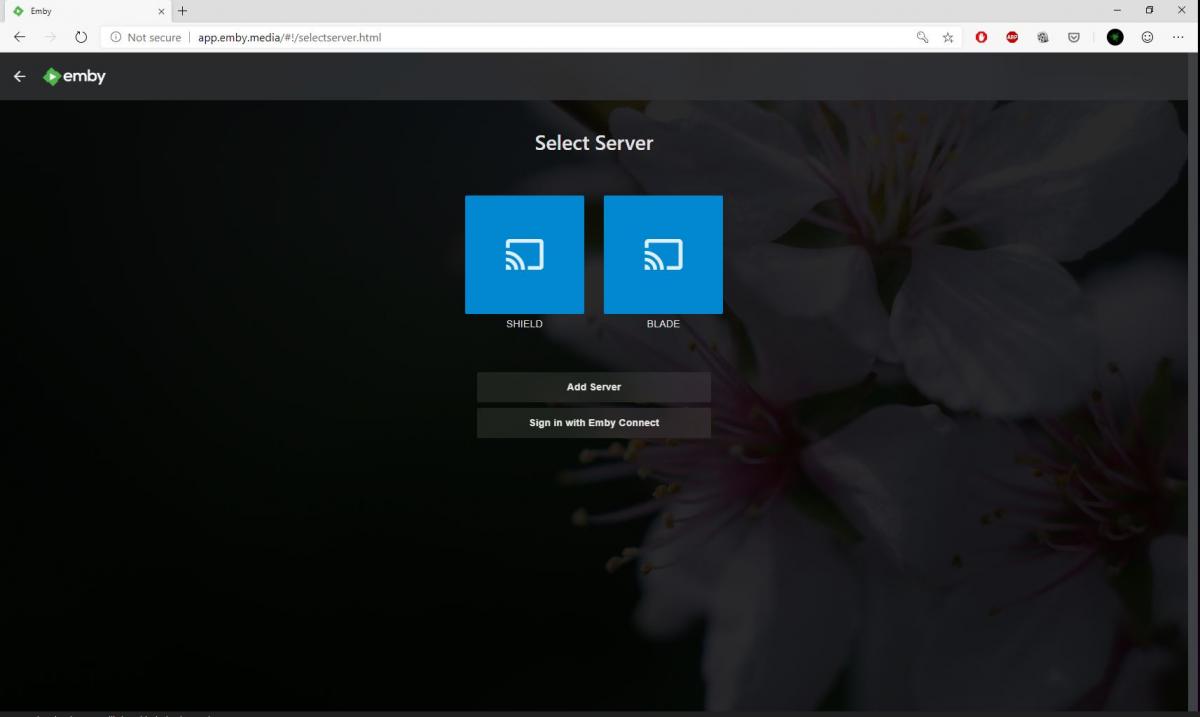

  • Solution
Try removing it from your connect account and then redoing the linking process.
  • Like 1
GrimReaper
That did the trick. :)
(Although curious what went wrong the first time. Anyway, sorted, thanks.)
