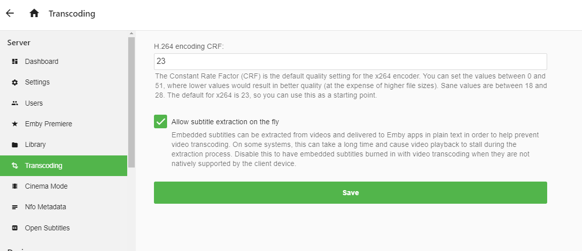

dave1255 0 Posted August 2, 2019 Author Posted August 2, 2019 I've tried turning on and off the setting 'allow subtitle extraction on the fly' as I've read this was the problem in other posts. I believe it will burn in subtitles when this option is disabled. It was ticked and on as in the attached screenshot during the last set of logs, is it possible the setting is not actually changing? Thanks
Solution Luke 42219 Posted August 2, 2019 Solution Posted August 2, 2019 These subtitles are PGS format. Burning them in is the only option for these if you're playing from the web app. That means that checkbox has no effect on your tests here. What i mean by turn the subtitles off is turn them off in the video player so that they're not displayed. Or better yet, turn them off prior to playback on the video detail screen. 1
