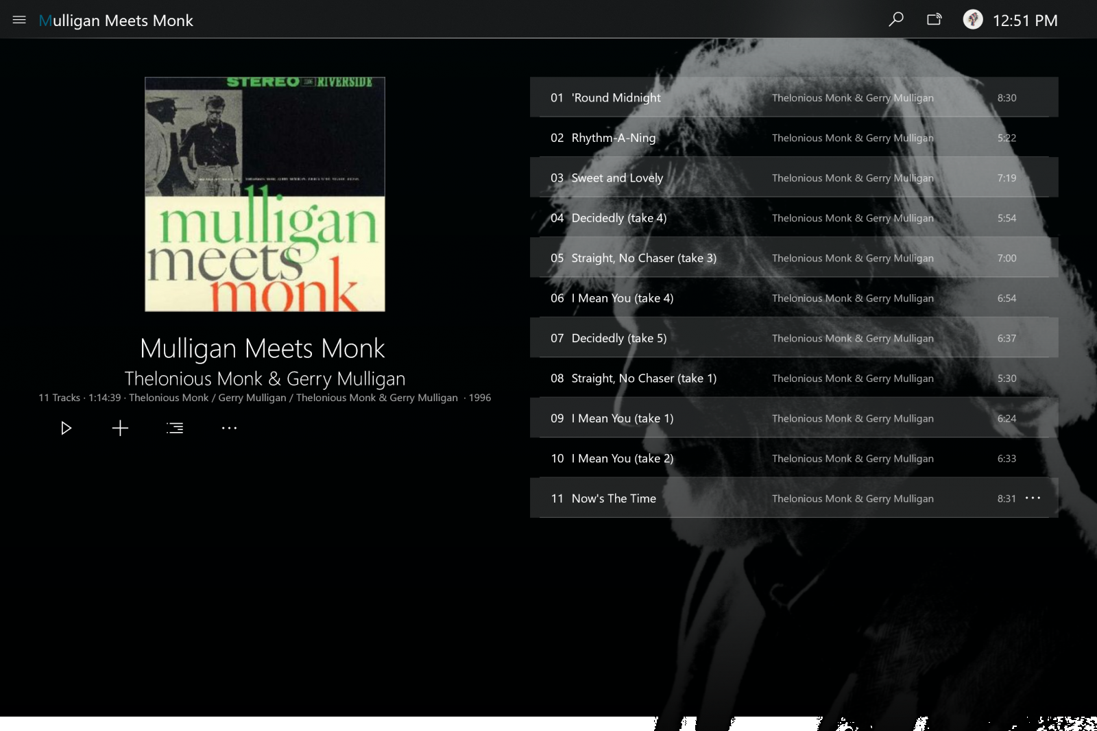

Vicpa 612 Posted July 29, 2019 Posted July 29, 2019 Hi @@Luke Sure is. Maybe it is just the c# apiclient ? See below you will see the artists in the genre fields and in the tracks you will see the album artist not artists. they in this case should appear as Thelonious Monk; Gerry Mulligan Thanks,
Luke 42221 Posted July 29, 2019 Posted July 29, 2019 Hi @@Luke Sure is. Maybe it is just the c# apiclient ? See below you will see the artists in the genre fields and in the tracks you will see the album artist not artists. they in this case should appear as Thelonious Monk; Gerry Mulligan Thanks, The app needs to update to this: https://emby.media/community/index.php?/topic/19790-artistitems-property So yes, one of our apps is guilt too, but that is being corrected. there is an issue in 4.2 with the old properties, but waiting on a fix for that is not the best approach as the old properties are on the near future deprecation list anyway.

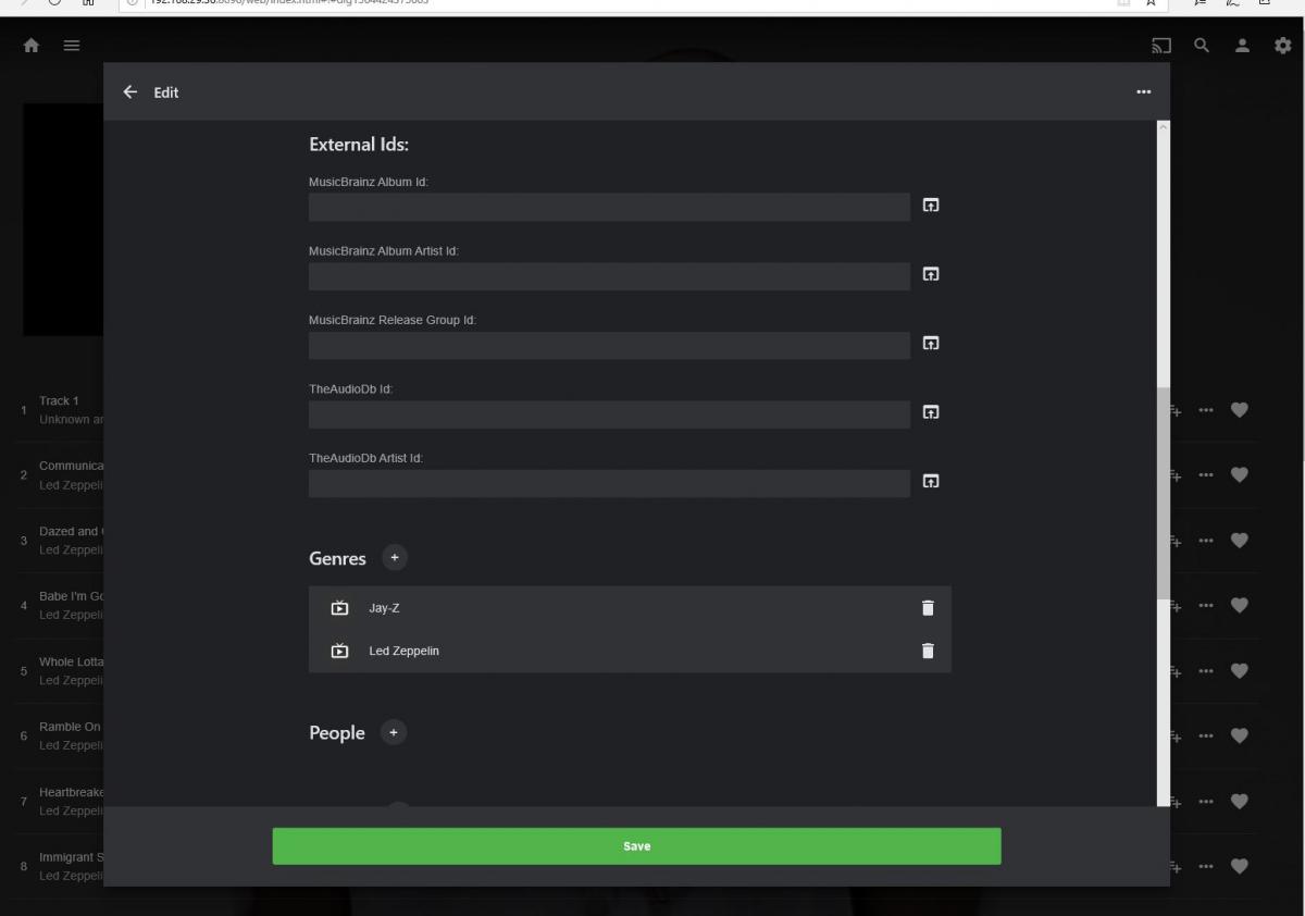

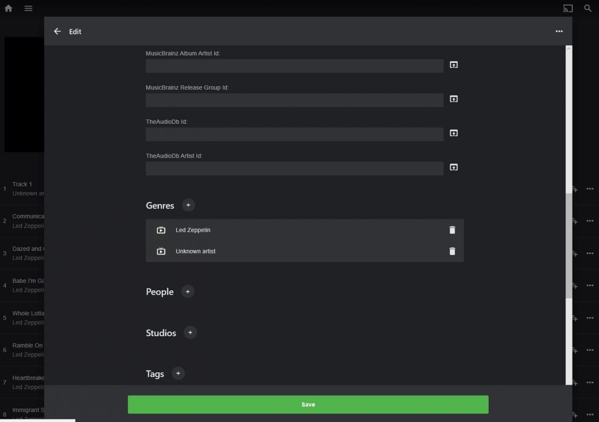

jachin99 88 Posted July 29, 2019 Author Posted July 29, 2019 (edited) I opened the Emby Web app as the administrative user who has permissions to manage the library and make changes. I selected the artist sort under music, then selected one of the unknown albums listed under unknown artist. This one happened to be a Led Zepplin album. In the Before genre edit screenshot below you can see Jay-Z is not listed, and I think it says something like Led Zepplin, and unknown Artist. So I pressed the more button chose to edit the metadata to remove all genres. Afterwards I hit save. I then hit the more button again to check the genres, and in the screenshot called after genre edit you can see led zeppelin, and JayZ listed as the genre, and the backdrop on the album's web page shows JayZ fanart. I hope that is more descriptive, and I can provide more info if need be. Thanks. Edited July 29, 2019 by jachin99 1

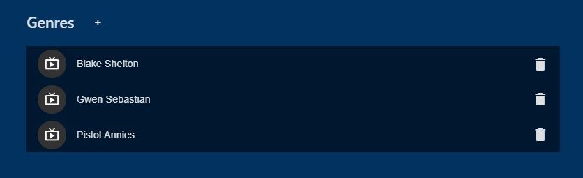

Happy2Play 9806 Posted July 30, 2019 Posted July 30, 2019 I am seeing this on my beta server .35 but not on stable .40. Will try a new build when I get at chance. Web Client UI appears fine but MM/Edit metadata on Album or Track show this.
