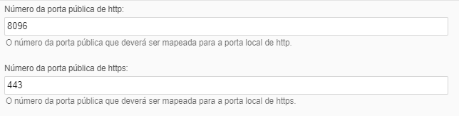

Wagner Moreira 1 Posted July 28, 2019 Posted July 28, 2019 I would like to know how to modify port 8096 to 443 on linux ubuntu. Informing that I use a vps.
neik 874 Posted July 28, 2019 Posted July 28, 2019 (edited) You can use the settings under "Advanced" to change the port. Edited July 28, 2019 by neik
Wagner Moreira 1 Posted July 28, 2019 Author Posted July 28, 2019 I changed it to port 443, but ended up losing the connection to the panel.
Luke 42246 Posted July 29, 2019 Posted July 29, 2019 Why did you lose access to the server dashboard? Did you set the regular http port as 443? If so, why?
Wagner Moreira 1 Posted July 29, 2019 Author Posted July 29, 2019 I am new to this system and I am learning, I modify the port but when it adds to the browser no longer loads the page. I use on a dedicated server from ovh, with ubuntu system.
Luke 42246 Posted July 29, 2019 Posted July 29, 2019 443 is something you would set for the https port, not the http port. Are you still able to get into the web app using the :8096 port?
Wagner Moreira 1 Posted July 29, 2019 Author Posted July 29, 2019 I will try to make this change here now
Wagner Moreira 1 Posted July 29, 2019 Author Posted July 29, 2019 (edited) no friend, i formatted the vps and installed emby again. I could not modify the port, would you have any tutorial to help me? my vps is on ubuntu 14.04 Edited July 29, 2019 by Wagner Moreira
Luke 42246 Posted July 29, 2019 Posted July 29, 2019 You can get to the wiki article for that screen by clicking the Help button at the top, but this question is really about your personal setup. It sounds like you want to set the public https port to 443.
Wagner Moreira 1 Posted July 29, 2019 Author Posted July 29, 2019 correct but i'll look where you informed me
Q-Droid 1011 Posted July 29, 2019 Posted July 29, 2019 no friend, i formatted the vps and installed emby again. I could not modify the port, would you have any tutorial to help me? my vps is on ubuntu 14.04 Ports 1024 and below are privileged. In other words root level access is needed to bind them. It's easier to keep the standard ports for emby and proxy or forward the entry point.
