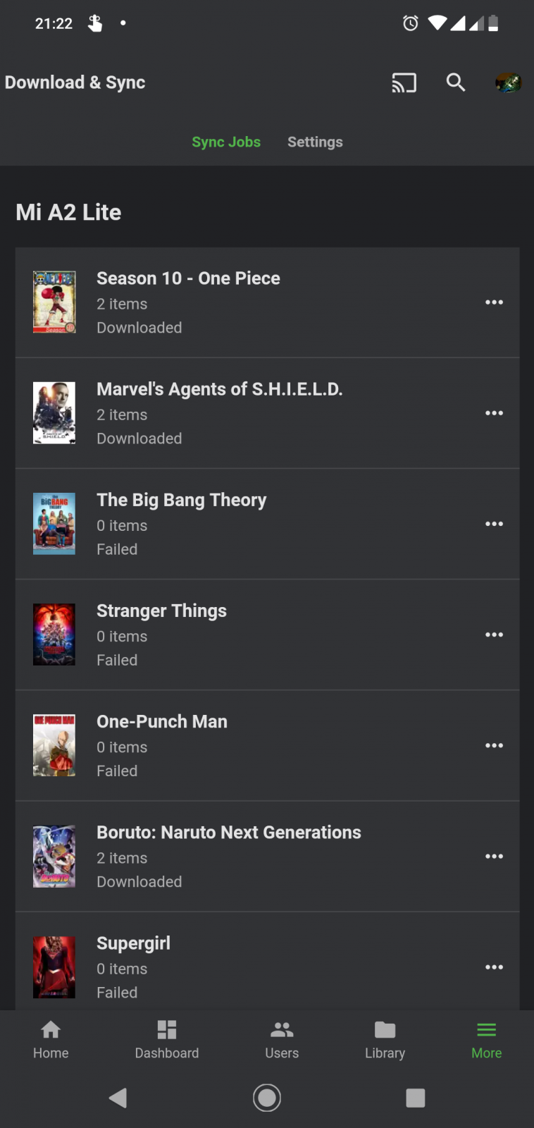

Bazzu85 22 Posted July 27, 2019 Posted July 27, 2019 Hi, with the latest release I have this problem.. when watching some content on phone the status of play is not synced with server.. I have now one episode full watched on phone (watched yesterday), no update on server so it will not download next.. I have anothe one episode half watched on phone (watched 4 hour ago), no progression update on server.. with previous release the full watched episode were marked as watched on server, half watched are updated so I can resume from "Continue Watching" help!
Bazzu85 22 Posted July 27, 2019 Author Posted July 27, 2019 (edited) I attach some screens.. as you see Agents of shield is fully watched on phone, no update on server.. same thing for One Piece season 10.. Edited July 27, 2019 by Bazzu85

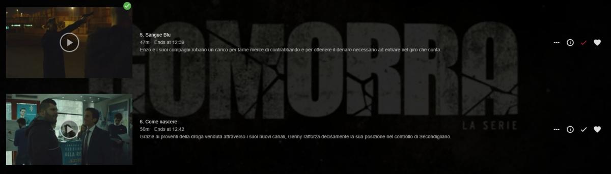

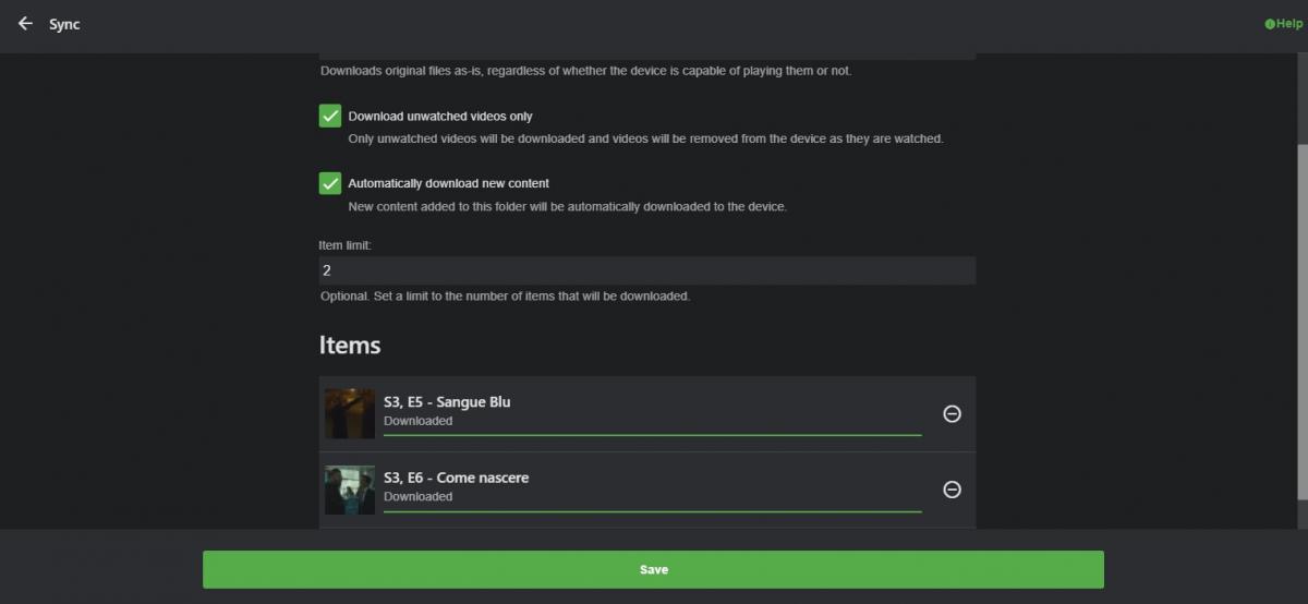

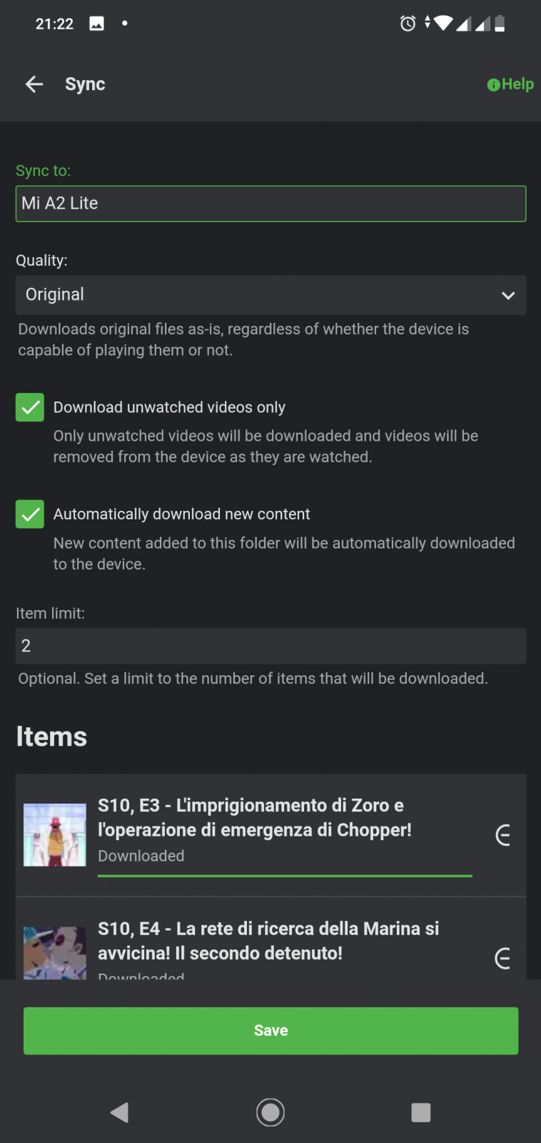

Bazzu85 22 Posted July 27, 2019 Author Posted July 27, 2019 (edited) I think the "sync" entries you see are the access to the sync page.. I attach some screen.. As you see for "One Piece - Season 10" I have 2 downloaded item: episode 3 and 4. To test the sync I setted 2 hours ago as unwatched the episode 2 so the situation of the jobs must be to sync episode 2 and 3. As you see this is not refreshing in these 2 hours.. Edited July 27, 2019 by Bazzu85
