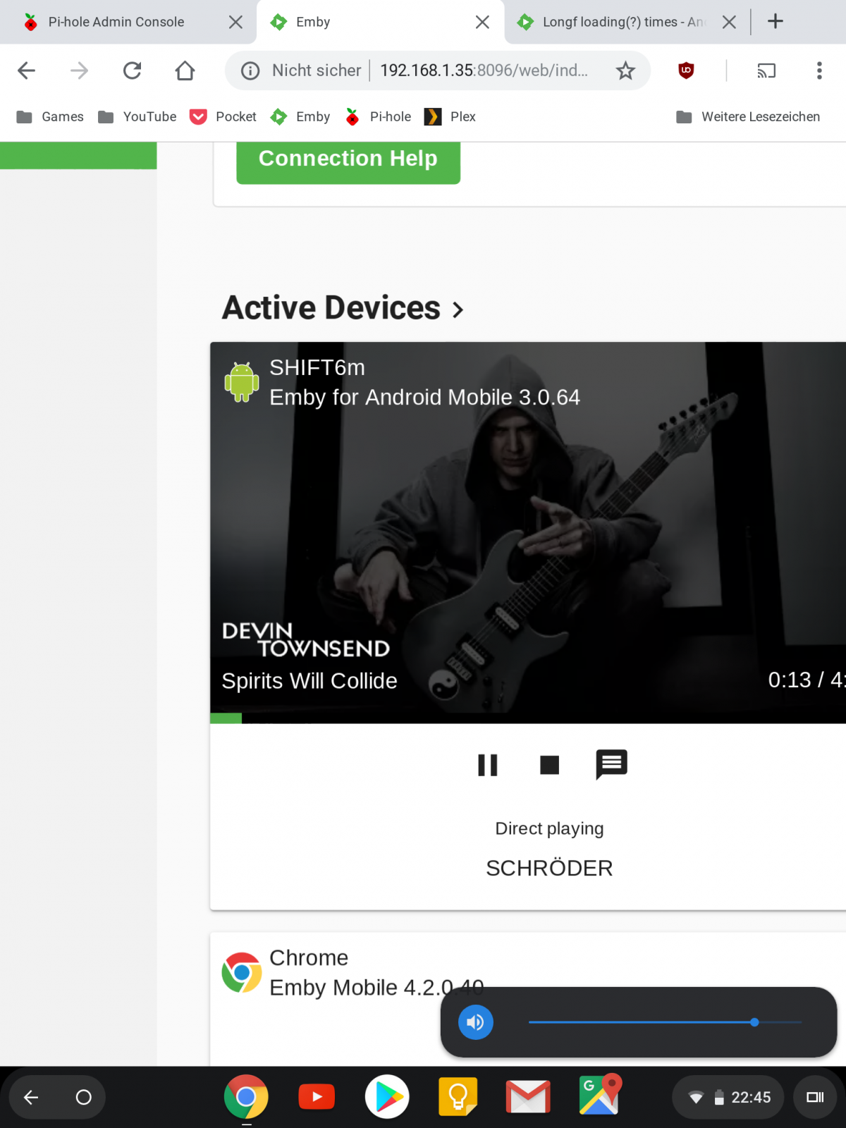

Raketenforscher 0 Posted July 27, 2019 Posted July 27, 2019 (edited) Hello, I use emby server on NVIDIA Sield TV, accessing an audio library on a SMB network share. When I use the web frontend via browser, playback starts immediately after hitting the play button. However, using the android app 3.0.46, after hitting the play button, it takes about a minute or so for the playback to start. What I tried so far: - clear app cache and memory data on client device - same result - delete app, reboot phone, install app again - same result - restart server app - same result - updated server app to 4.2.0.40 - tried playback on three different Android devices - same result Attached txt file includes emby server debg log. I can't provide a client log, because I have no log folder on my device (see screenshot) Thank you. edit: Sorry for typing error in topic. Could some admin please edit? embyserverlog.txt Edited July 27, 2019 by Raketenforscher

Raketenforscher 0 Posted July 31, 2019 Author Posted July 31, 2019 Things are getting more confusing. Some files start playback immediately, others take some time. The duration of delay until playback start varies. I got the impression, that it corresponds to tbe duration of the audio track or the size of the file. In the server dashnoard I can see the progress bar growing (see screenshot) for the time of delay, then it resets to zero and the actual playback starts.
