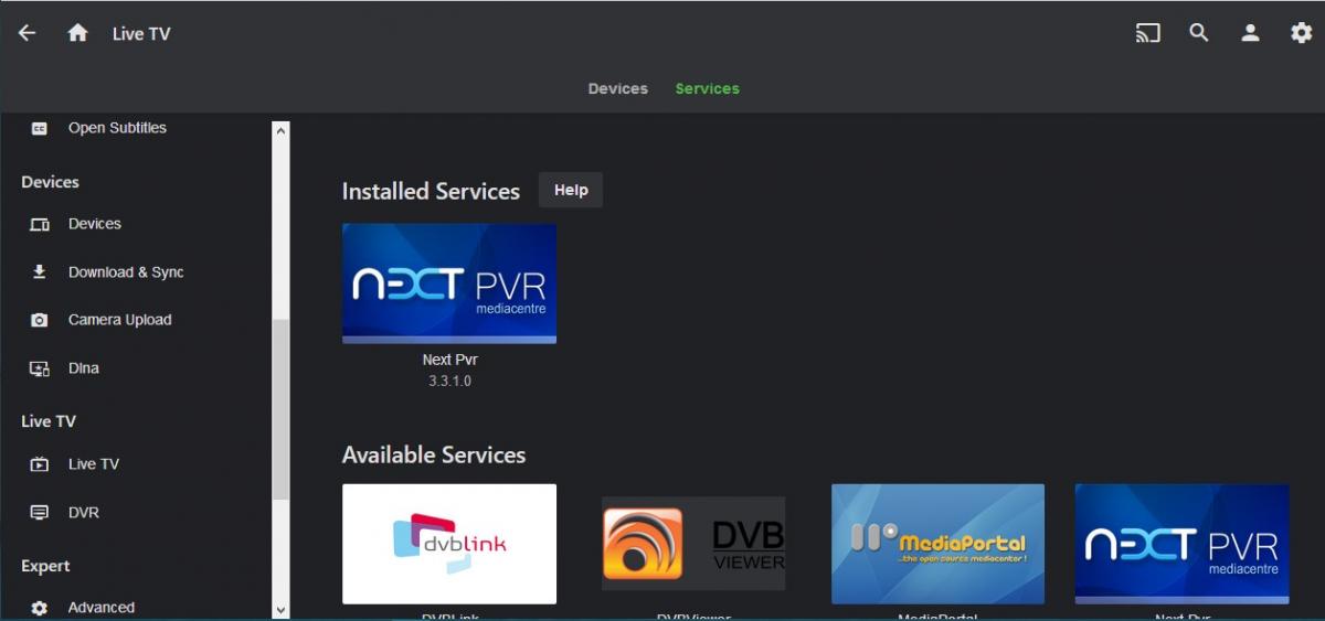

raymondjpg 16 Posted July 26, 2019 Posted July 26, 2019 Don't know if this is in the right place, but I found when Emby Server updated to v4.2.0.40 that I couldn't configure a new Live TV Service. With the previous version 4.1.1.0 there were two menu items under Live TV at the top of the page, Devices and Services. These menu items are no longer visible in 4.2.0.40, at least in Firefox 68.0.1. Is the setup somewhere else on the page in the new server version? I couldn't locate it. TIA

raymondjpg 16 Posted July 26, 2019 Author Posted July 26, 2019 (edited) Have you clicked on the + symbol next to TV Sources ? Thanks for the response, but that option is the Devices option, and I need the Services option which enables installation of plugins such as Vu+ and Next Pvr. See attachment. Edited July 26, 2019 by raymondjpg

raymondjpg 16 Posted July 26, 2019 Author Posted July 26, 2019 Click the + button next to tv sources and then select other. Please let us know if this helps. Thanks. I did try that but it did not help. Did you click on the "Catalog" tab at the top of the page? I didn't, but I see now that you have pointed it out to me that in Server v4.1.1.0 that link does bring up other Live TV services such as Vu+ and clicking on the Vu+ plugin does open up a dialogue to install it. Am I to take it that this is now the way to install Live TV services, and not from the Live TV page which previously gave am option for Devices or Services? Or is this a bug that will be fixed to once again give these two options on the Live TV page of the Server setup?
Luke 42221 Posted July 26, 2019 Posted July 26, 2019 It is amazing how a small design change can end up being perceived as a problem or bug. I'm not blaming you, it happens all the time. If you click the + button next to TV sources it tells you exactly what to do. Browse the Emby plugin catalog to install additional Live TV providers. Ok so click the plugin catalog link, then locate Next Pvr, install it, and everything will be exactly the same as before.
Luke 42221 Posted July 26, 2019 Posted July 26, 2019 All i did was remove the redundancy of the Services tab, which means you now have to use the plugin catalog to install it. I put the "Other" option in TV sources so that the help text would hopefully end up guiding you there.
