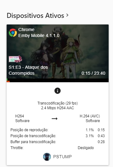

Pstump 0 Posted July 21, 2019 Author Posted July 21, 2019 ok i made some tests, and this time i taked the time, 11 minutes and 50 seconds to start reproduzing the episode.... these playback is making transcoding of h264 to h264(avc) (logs and foto of session attached, it`s in portuguese but you can retrieve the important data) the strange thing is that the server is taking 12 minutes to start the job, is not 12 minutes of buffer but 12 minutos to start the process of sending the data. ok, all the logs and etc is there, i dont know what i can do. the dash board is sayng: the transcoding is happening because the subtitle is not supported, what is strange because is one subtitle inside the archive and the live extract of subtitle is turned off (doesnt make any difference turning on, but it make complex subtitles bug). one more thing, when the process starts, the process is ok, the transcoding is realy fast and etc... is like the server is taking a lot of time thinking what to do when i start something(in web browser, again, in chrome). Log.txt Log ffmpeg.txt

Pstump 0 Posted July 21, 2019 Author Posted July 21, 2019 i have made some more tests, and the problem in these case, sems to be the subtitle thats in the archive, these is making the emby to transcode the archive (because the live subtitle extract is off), if i turn it on and watch the same thing, the direct play is almost instant, but at the same time, i can put at any quality and force the emby to transcode, and no problem there, for sure it takes longer to play, but is something like 5 to 10 seconds max, not 12 minutes, so the problem is when it has to convert h264 to h264(avc) because the player cant handle the ass subtitle(i cant understand why not), i could set the live subtitle extract on, but it brokes some anime subtitles, like one that have two subtitles at same time(music and speach for exemple) sometimes it shows only one and sometimes doesnt show at all, and it brakes all the font style so is a little boring, theres some way to prevent the emby to do these kinda stupid transcode? or theres some fix to these essue?
