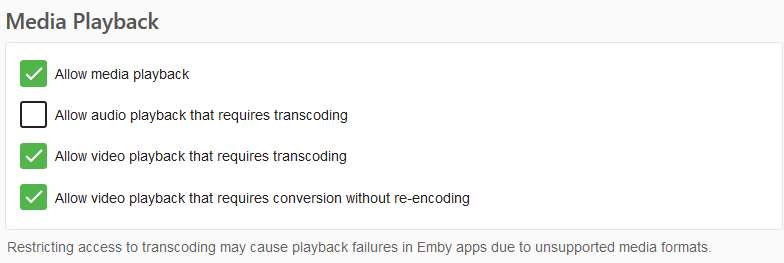

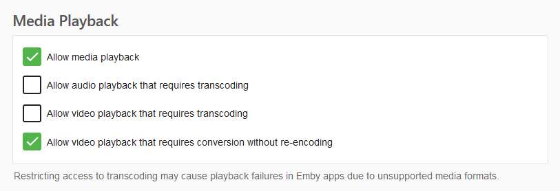

flakie 11 Posted July 7, 2019 Author Posted July 7, 2019 (edited) OK, after a bit of testing it seems it is the audio that is the problem.With audio transcoding off (and video transcoding on) it fails to play.With audio transcoding on (and video transcoding off) it plays OK. Video is Wolf Creek 2005Wolf creek (2005).mp4First test is with video and audio transcoding turned off.Playing from android app to chromecast.Attempted to cast it.It appears like it is about to play but after about 10+ seconds it goes back to ready to cast screen.Repeated test a few seconds later with same result. Second test is with audio transcoding turned on (video transcoding turned off).Again Playing from android app to chromecast.Video plays OK. Third test is with video transcoding turned on (audio transcoding turned off).Again Playing from android app to chromecast.It appears like it is about to play but after about 10+ seconds it goes back to ready to cast screen.Repeated test a few seconds later with same result. Edited July 7, 2019 by flakie
flakie 11 Posted July 7, 2019 Author Posted July 7, 2019 These are the ones when all transcoding was turned off (rest to follow):

flakie 11 Posted July 7, 2019 Author Posted July 7, 2019 These are the ones when only video transcoding was turned on:
Luke 42242 Posted July 7, 2019 Posted July 7, 2019 When the audio codec is AAC, Chromecast does not support more than 2 channels. Please note - You did not need me to answer this. The server dashboard can tell you why it is transcoding.
