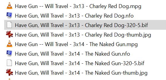

The name of the TV show that is in my recording folder is >> "Have Gun, Will Travel - 3x14 - The Naked Gun"
The name of the TV show that is set to Play is named >>>  "
Have Gun -- Will Travel - S3 14. Naked Gun
Recorded show has a coma after Gun, the scheduled show has -- after gun...............  Guess that means they are not the same show..

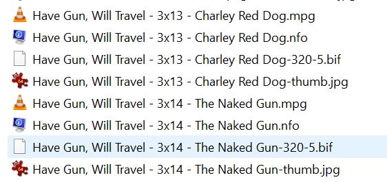

Saga continues, following Lt. Columbo's lead, I tried some sleuthing.   First I tried renaming three of the Have Gun Will Travel to the format that Emby recognizes, thinking that was the issue, but NO.  Those 3 files that I change the names to, STILL show set to record.  I even did a complete library re-scan.

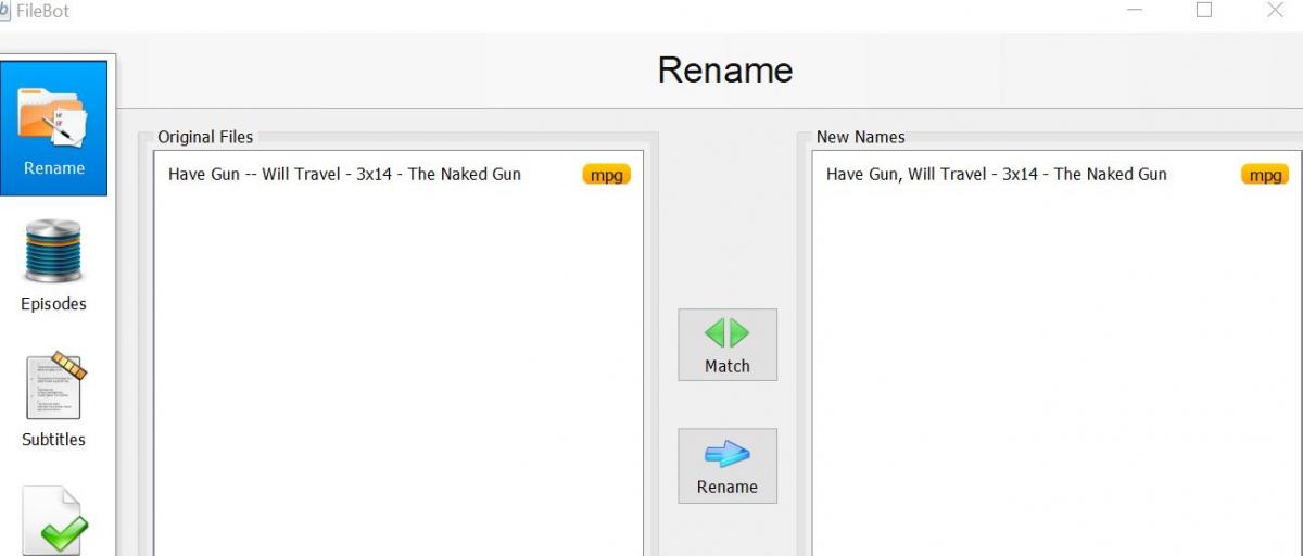

Next, I am going to MOVE those 3 episodes to my Emby recording destination, and see if that helps........  stay tuned.......  BTW, I found out that Filebot changed the series name, and placed a "," in the series name.
Here is where Filebot changed the name of the series. post-38990-0-61115400-1562434749_thumb.jpg

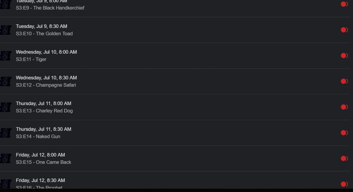

Even with name change, it is set to record.  post-38990-0-51722900-1562434899_thumb.jpg

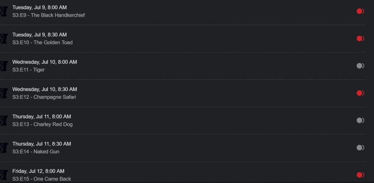

Final update, when I deleted the NFO and BIF files for each episode, now those episodes are NOT scheduled to record.............
So, it appears that Filebot changed the show name to something Emby did not like, so it could NOT match the metadata that was being supplied by the episodes.  Changing the name to match the metadata alone did not help.  I had to change the episode name AND delete the NFO file..............

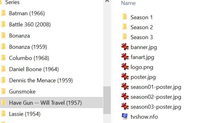

Moved all my "Have Gun Will Travel" episodes from my WD NAS to my Emby series recording destination, now everything is working as it should. Did not even have to change the name.
