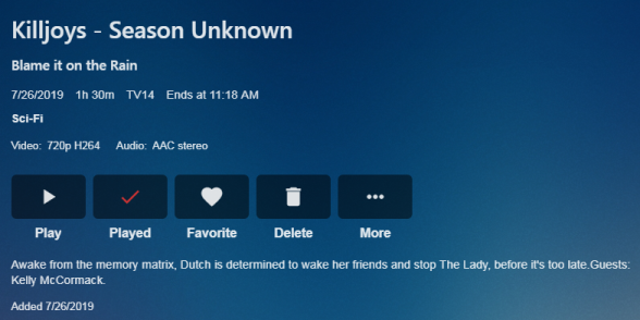

mark-in-dallas 87 Posted July 28, 2019 Author Posted July 28, 2019 (edited) And I just found that I had a second recording from last night that did the same thing. A recording that should have only been 1 hour long is 1h 30m instead and the scene repetitions start from the very beginning and continue throughout the entire recording. Different channel and different show. Edited to add: Another 2 shows from last night on the same channel as the last recording that experienced issues, one from 2 hours earlier and one that recorded an hour later had no issues and recorded fine. I also wanted to add that I do realize that with coding it should either work or not work, and that intermittent issues are usually not caused by faulty coding, but I'm wondering if it could be an issue related to stream fault tolerances? Could a short glitch in the stream possibly be the cause? My reasoning is that the the logs show that the last 2 recordings with the repeating segment issues started and stopped on time, but one of those recordings was actually 34 minutes longer than it should have been, and the other is 30 minutes longer than what it should have been and what the log shows as starting and stopping points. From the Log: Line 7608: 2019-07-26 20:00:02.497 Info LiveTV: Will record to /shares/tv/Ancient Aliens/Ancient Aliens 2019_07_26_20_00_00.ts for 62.9583797866667 minutes. Line 7633: 2019-07-26 20:00:02.600 Info LiveTV: Triggering refresh on /shares/tv/Ancient Aliens/Ancient Aliens 2019_07_26_20_00_00.ts Line 7634: 2019-07-26 20:00:02.602 Info LiveTV: Refreshing recording parent /shares/tv/Ancient Aliens Line 7635: 2019-07-26 20:00:02.602 Info LiveTV: Copying recording stream to file /shares/tv/Ancient Aliens/Ancient Aliens 2019_07_26_20_00_00.ts Line 8516: 2019-07-26 21:03:00.250 Info LiveTV: Recording stopped: /shares/tv/Ancient Aliens/Ancient Aliens 2019_07_26_20_00_00.ts Line 8192: 2019-07-26 21:00:00.641 Info LiveTV: Will record to /shares/tv/Killjoys/Killjoys 2019_07_26_21_00_00 - Blame it on the Rain.ts for 59.989309475 minutes. Line 8219: 2019-07-26 21:00:00.829 Info LiveTV: Triggering refresh on /shares/tv/Killjoys/Killjoys 2019_07_26_21_00_00 - Blame it on the Rain.ts Line 8220: 2019-07-26 21:00:00.830 Info LiveTV: Refreshing recording parent /shares/tv/Killjoys Line 8221: 2019-07-26 21:00:00.831 Info LiveTV: Copying recording stream to file /shares/tv/Killjoys/Killjoys 2019_07_26_21_00_00 - Blame it on the Rain.ts Line 9135: 2019-07-26 22:00:00.260 Info LiveTV: Recording stopped: /shares/tv/Killjoys/Killjoys 2019_07_26_21_00_00 - Blame it on the Rain.ts Screen capture of episode info in Emby Recordings Edited July 28, 2019 by mark-in-dallas
