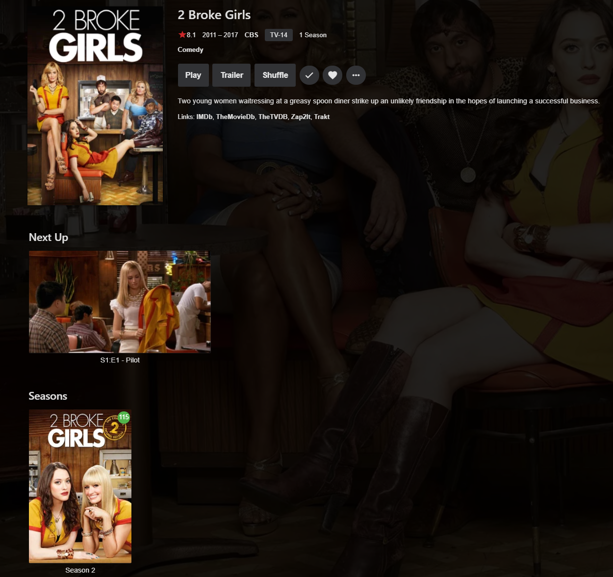

Misinthe 46 Posted June 27, 2019 Posted June 27, 2019 Hey everyone, I am having this weird issue were one TV Show (2 Broke Girls) it showing all the episodes stack together in "Season 2", the weird part is that all the metadata is good for all the episodes in the show, so it does recognize it's from S01 to S06. But it bundles them up into 1 "Season 2" folder. Has anyone experienced this before? Few things to add. I am pulling the metadata from TheTVDB.com which has all the episodes separated by seasons accordingly. My path is set as G:\TV Shows\2 Broke Girls, and I have individual folders for each season. The Episodes are named 2 Broke Girls S01E01 and so on, so that shouldn't be a problem either. Here are some screenshots. Thank you all for your help!

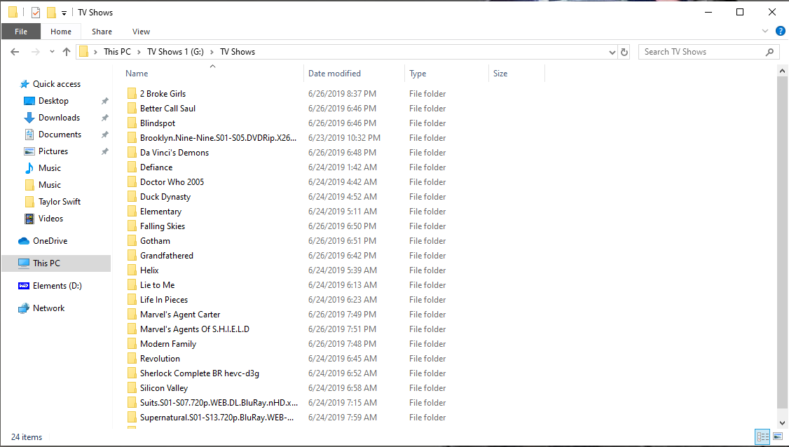

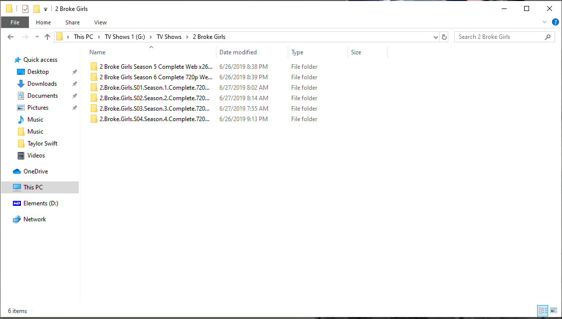

ebr 16949 Posted June 27, 2019 Posted June 27, 2019 Can we please see the exact contents of the file system for this series? (explorer screenshots)
Misinthe 46 Posted June 27, 2019 Author Posted June 27, 2019 Can we please see the exact contents of the file system for this series? (explorer screenshots) Yes sir, I will post them tonight when I get back home. Thank you for your help.
Misinthe 46 Posted June 27, 2019 Author Posted June 27, 2019 Can we please see the exact contents of the file system for this series? (explorer screenshots) Here are some screenshots that should help you understand, I also took some of another TV Show so you can see that it is the same structure and it works fine on other shows. Please let me know if you need any more information. Thank you for your help.
Solution Gilgamesh_48 1252 Posted June 27, 2019 Solution Posted June 27, 2019 While Emby tries VERY hard (I believe too hard) to conform to all the possible naming/structure schemes that abound I believe we, as content owners, should help as much as possible. The following is the structure and naming I use and it works every time without a single exception I have found. - - - - - - - - - - TV Shows <- The TV library points here _______ShowName (year) ____________Season 01 __________________ShowName (year) - s01e01 - Optional Name.ext __________________ShowName (year) - s01e02 - Optional Name.ext __________________and so on for the shows in season 01 ____________Season 02 <- just like Season 01 ____________Season 03 <- and so on for each season ____________Season 00 <- or “Specials” __________________ShowName (year) - s00e01 - Optional name __________________ShowName (year) - s00e02 - Optional name __________________and so on for each special Note 1: the eXX part of the specials must match EXACTLY what is found in TheTVDB Note 2: The (year) may be omitted for shows that do not have more than one occurrence throughout the years. There are many other structures and naming systems that work but this is the one I use and it just works. For a mass rename I use FileBot with this format string {n.replaceTrailingBrackets()} - {s00e00.lower()} - {t} There is also a "Plex" preset that works very well for Emby as well. 2
Misinthe 46 Posted June 28, 2019 Author Posted June 28, 2019 While Emby tries VERY hard (I believe too hard) to conform to all the possible naming/structure schemes that abound I believe we, as content owners, should help as much as possible. The following is the structure and naming I use and it works every time without a single exception I have found. - - - - - - - - - - TV Shows <- The TV library points here _______ShowName (year) ____________Season 01 __________________ShowName (year) - s01e01 - Optional Name.ext __________________ShowName (year) - s01e02 - Optional Name.ext __________________and so on for the shows in season 01 ____________Season 02 <- just like Season 01 ____________Season 03 <- and so on for each season ____________Season 00 <- or “Specials” __________________ShowName (year) - s00e01 - Optional name __________________ShowName (year) - s00e02 - Optional name __________________and so on for each special Note 1: the eXX part of the specials must match EXACTLY what is found in TheTVDB Note 2: The (year) may be omitted for shows that do not have more than one occurrence throughout the years. There are many other structures and naming systems that work but this is the one I use and it just works. For a mass rename I use FileBot with this format string {n.replaceTrailingBrackets()} - {s00e00.lower()} - {t} There is also a "Plex" preset that works very well for Emby as well. I just changed the season's folder name to "Season XX" and it worked. I appreciate your help, and that FileBot program is AWESOME! It is going to save me so much work, I actually had to fix my Dragon Ball and Pokémon libraries one by one because I didn't know about this! Had to modify over 2000 episode manually! I purchased the license and it works like a charm, Thank you for the suggestion!
Happy2Play 9840 Posted June 28, 2019 Posted June 28, 2019 (edited) Most of the time you want to be as close to the supported naming conventions as possible. I am surprised you have not run into more issues with those series and season names. https://github.com/MediaBrowser/Wiki/wiki/TV-naming You also have to watch out for what sub-folders that are added also. Edited June 28, 2019 by Happy2Play
Misinthe 46 Posted June 28, 2019 Author Posted June 28, 2019 Most of the time you want to be as close to the supported naming conventions as possible. I am surprised you have not run into more issues with those series and season names. https://github.com/MediaBrowser/Wiki/wiki/TV-naming You also have to watch out for what sub-folders that are added also. I've run into problems before, like I said with a couple of anime shows, but what I had never gotten was everything in 1 Season with the right Metadata on all the episodes, usually when it's all busted like that, you'll have the right season Metadata and the other episodes havo no description with the name in your files.
