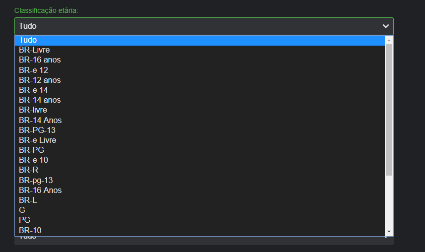

mauriciomaurente 2 Posted June 27, 2019 Posted June 27, 2019 My question seems simple, but I did not find any topic that addressed that specific topic. In my collection of films and animations, when I filter those titles that a child can watch alone, in my country are classified as BR-L, that means free for all ages. But for some TMDB problem or whatever, there are ratings from other countries like the United States, Europe, Australia, ... I know this is not a problem with Emby, and Emby offers to edit one by one, manually changing to and blocking this feature so that it does not change in the future. But this is a time-consuming job because I have many titles. I've tried using MediaElch which allows you to modify multiple movies at once for a single rating, but it seems that Emby does not talk to MediaElch. Am I doing something wrong or is there no other way to do this?

Happy2Play 9806 Posted June 29, 2019 Posted June 29, 2019 (edited) I guess the question would be where do those other ratings fall on the localization restictions? I would assume they would be considered unknown and only be block if you have enabled "Block items with no or unrecognized rating information:" *Emby-Server\programdata\localization\ratings-br.txt BR-L,1 BR-10,5 BR-12,7 BR-14,8 BR-16,8 BR-18,9 But if MediaElch can bulk edit, what tag/node is being used that Emby is not reading classification? My comment about Tags (post 2) was for you to use MediaElch to bulk Tag your media for Emby to read. Edited June 29, 2019 by Happy2Play

mauriciomaurente 2 Posted June 29, 2019 Author Posted June 29, 2019 Luke, when you say "if we do," you mean a change in Emby's system, right? Well, I had not thought that would go that far, but I think positively that anything else would be palliative. The problem is that there are absurd classifications that simply do not exist, like BR-PG-13 ... It's an American-Brazilian hybrid, a Frankenstein that some crazy created in the TMDB. And Kodi that uses the server, gets even more confused. If we move to this type of system where you just check boxes of allowed ratings, then we don't have to bother trying to convert the rating to an age number anymore. Then it's just a simple test of is the content rating in the allowed list or not. This will make it easier for us to allow users to add arbitrary new ones.
