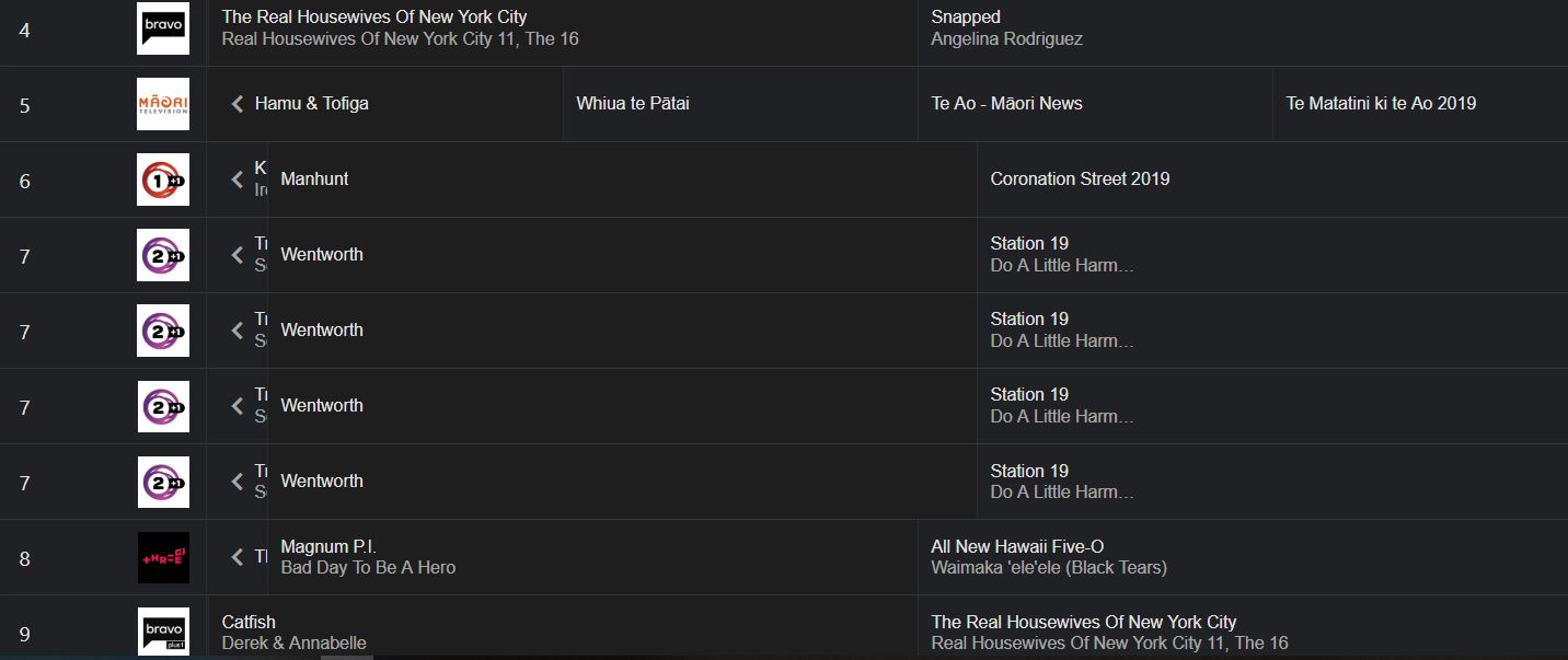

arrbee99 1836 Posted June 26, 2019 Posted June 26, 2019 I previously had three m3u tuner lists and at least one xmltv guide installed plus the NextPVR plugin, now version 5. I decided to get rid of all the m3u tuner lists and xmltv guides and try going back to just using the Nextpvr plugin. I've tried restarting the server and updating the guide but just can't get rid of a lot of the old channels. Any thoughts please. For instance. the 4 '7' channels below, despite looking similar, are actually 4 different channels when you hover over the different Sevens. There are lots of other channels lower down that should have been deleted but weren't and channels I just added to NextPVR that I presume should show up when I update the guide in Emby.

arrbee99 1836 Posted July 1, 2019 Author Posted July 1, 2019 So I removed NextPVR plugin, stopped the server and renamed library.db to library.db.old and restarted the server. Finally all Live TV has disappeared. Hopefully i'll be able to have a go with the updated plugin properly now. Interestingly (to me) my library.db file has gone from 490MB to 146MB. Bit of a difference, hopefully for a good reason.
