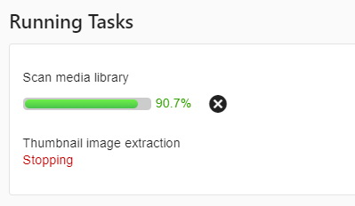

davesurfer 18 Posted June 24, 2019 Author Posted June 24, 2019 Did you try running a library scan? I've done that before yes, it takes forever, and it does find missing metadata...because it takes so long I just go into the metadata browser and just manually do a scan on the folder with newly added content and find missing metadata. I just looked again right now and see this running anyways, probably the daily scheduled task or whatever, then the thumbnail thing "stopping":
Luke 42221 Posted June 24, 2019 Posted June 24, 2019 Have you enabled the realtime monitor for each of your emby libraries?
davesurfer 18 Posted June 26, 2019 Author Posted June 26, 2019 Have you enabled the realtime monitor for each of your emby libraries? Realtime monitoring is on for both libraries. Like I said, it was working fine before, there were no settings changes or nothing was toggled on or off.
Luke 42221 Posted June 26, 2019 Posted June 26, 2019 Currently the realtime monitor is not active when a scan is running. It's something we can look at improving, but based on your log example that looks to be the reason why.
