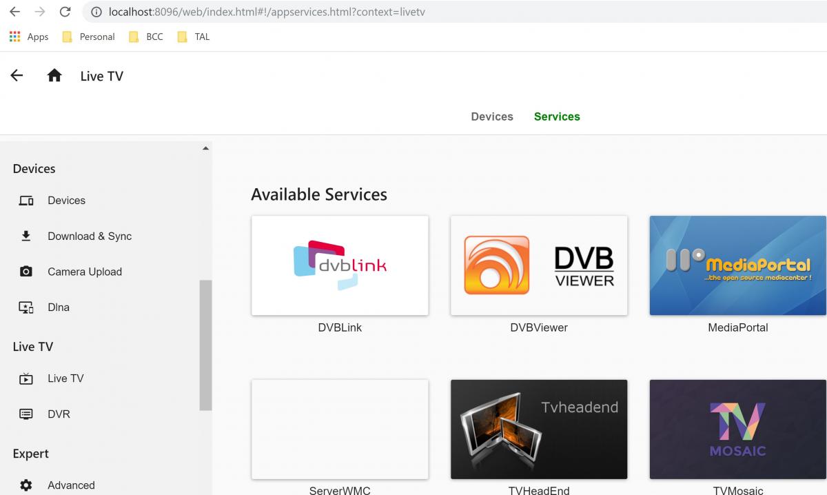

Mbedford 7 Posted June 19, 2019 Author Posted June 19, 2019 Emby server Log attached and some screenshots showing the current config. Live TV is playing now but, On guide screen, only 6 out of the 30+ channels I have are showing, on channels screen all channels are showing on guide screen there is no over the air guide data being displayed from the channels. Log.txt
