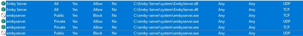

Happy2Play 9806 Posted June 16, 2019 Posted June 16, 2019 What inbound rules do you have for "Emby Server" in your firewall? Example from one of my installations Private network allowed. Public network blocked. So network type will have a factor with connections unless you are allowing both types. the pop-up during setup, there is a way to do this setup again and can list processes if needed. I can pm you NSSM is you would like. @@Luke if NSSM is not going to be available what would another options?
ErikaJ 65 Posted June 16, 2019 Author Posted June 16, 2019 (edited) Ahhh, I have the same rules except where yours says system, mine has my name. Maybe that is how/why my user cannot access. So what I should have done was install MB as THE administrator and not as an administrator, yes? If so then I would need to reinstall correct? edit Yes I did get the FW questions and answered to allow. But like I said I installed MB under my name as an administrator and not THE administrator. Edited June 16, 2019 by snaitaz
Happy2Play 9806 Posted June 16, 2019 Posted June 16, 2019 Ahhh, I have the same rules except where yours says system, mine has my name. Maybe that is how/why my user cannot access. So what I should have done was install MB as THE administrator and not as an administrator, yes? If so then I would need to reinstall correct? edit Yes I did get the FW questions and answered to allow. But like I said I installed MB under my name as an administrator and not THE administrator. Mine is actually a portable install but runs under the administrator account on always logged in Media user. The user account running Emby is not getting logged off correct as that will shut down the server?

Happy2Play 9806 Posted June 17, 2019 Posted June 17, 2019 Hello Happy...Wel since it is a Media Center app, I was under the impression that I could install it on 1 machine and it could be accessed by other users on my home network. Kind of like a real server works. My office applications and npvr and Kodi could all be accessed by others at my home but there was only 1 machine that hosted the application. So is this not the way MB works?? Cheers!! Yes Emby Server will present to all Emby clients/apps anywhere assuming there is not something in the environment blocking it. So it is a matter of figuring out what is blocking clients for accessing Emby on that host machine. It has been awhile since I have done a setup on a new machine but after looking at the firewall again, do you have rules for Port 8096 and Port 8920 (or your ports if changed)? https://github.com/MediaBrowser/Wiki/wiki/Connectivity#troubleshooting-internal-connections

ErikaJ 65 Posted June 17, 2019 Author Posted June 17, 2019 I have same connections as you list. I restarted MB several times deleted the library and restarted MB again. After it populated, I tried to access from the laptop and it!! I logged in as a regular user and it allowed me access as well. I think Mb was not running at the time when it failed to be accessed. So all is well for now. Hopefully, it remains this way. Thanks for your assistance and the PM. Cheers!! 1
