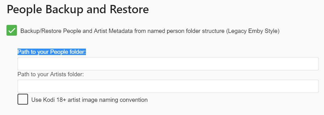

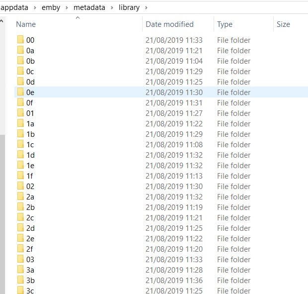

mbc0 68 Posted August 21, 2019 Posted August 21, 2019 Hi, on a fresh install what do I put as a path to my people folder? I looked under the metadata folder and cannot find anything for people?
pünktchen 1425 Posted August 21, 2019 Posted August 21, 2019 On newer Emby installations the people and artists folder under metadata aren't created anymore. So you can put in any path you want to create backups for the future.
mbc0 68 Posted August 21, 2019 Posted August 21, 2019 On newer Emby installations the people and artists folder under metadata aren't created anymore. So you can put in any path you want to create backups for the future. so if I put paths in that section of the plugin I mentioned above emby will then use that path to store artists / actors? I guess that will be from now on, what about all the people already scanned into the library? Thank you
pünktchen 1425 Posted August 21, 2019 Posted August 21, 2019 (edited) so if I put paths in that section of the plugin I mentioned above emby will then use that path to store artists / actors? I guess that will be from now on, what about all the people already scanned into the library? Thank you It's just a backup! So any customization you've done to metadata or pictures do not get lost after a fresh installation and you have the ability to restore it. Emby itself will still store the metadata to library.db and images to the folder structur of your screenshot above. You can do the backup on demand or create some triggers inside the task scheduler. Edited August 21, 2019 by pünktchen 1
mbc0 68 Posted August 21, 2019 Posted August 21, 2019 It's just a backup! So any customization you've done to metadata or pictures do not get lost after a fresh installation and you have the ability to restore it. Emby itself will still store the metadata to library.db and images to the folder structur of your screenshot above. You can do the backup on demand or create some triggers inside the task scheduler. Ah, sorry! I was overthinking it! Thanks for your time, completely understand now! ;-)
