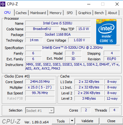

p_parente 0 Posted June 14, 2019 Posted June 14, 2019 I'm brazillian, so forgive me for my english. I was messing around with the transcoding settings (since I use a chromecast at home and HEVC is not supported) and found out I cannot use the maximum thread count without the stream stutters every 5 seconds or so. According to CPU-Z, I can use 4, if I am correct: The maximum I can use to play smoothly is 2, anyone knows why this happen?
pwhodges 2028 Posted June 14, 2019 Posted June 14, 2019 There are only two cores. The extra threads enabled by Hyperthreading are not as capable.

p_parente 0 Posted June 15, 2019 Author Posted June 15, 2019 There are only two cores. The extra threads enabled by Hyperthreading are not as capable. But why does that stutter the stream? I'm very noob with this stuff... I'm playing it on chromecast, my CPU is just transcoding... And it seems to be doing it fine by the painel. If I was watching on the PC i would get it, but why does chromecast gets affected?
Happy2Play 9806 Posted June 15, 2019 Posted June 15, 2019 (edited) Logs would show more information but basically it sounds like the processor can not process the media fast enough to keep up with the playback. Cores and threads do not mean that is how many transcode streams you can have. Edited June 15, 2019 by Happy2Play

ebr 16314 Posted June 15, 2019 Posted June 15, 2019 But why does that stutter the stream? I'm very noob with this stuff... I'm playing it on chromecast, my CPU is just transcoding... And it seems to be doing it fine by the painel. If I was watching on the PC i would get it, but why does chromecast gets affected? By setting that to a higher number, you are telling Emby to try and do more things at once than if it were a lower number and your CPU simply cannot handle that load. Basically, you've put too many bags on the camel's back. Does that makes sense?
