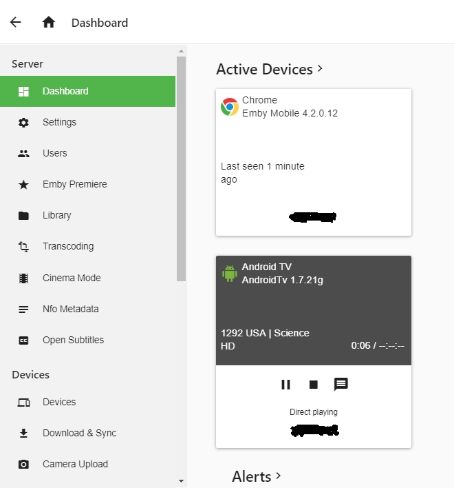

devz3ro 2 Posted June 10, 2019 Author Posted June 10, 2019 Just had someone at my house try it with a Shield TV I have. Looks like it's not just Kodi, the below screenshot is from the Kodi Android TV App.

devz3ro 2 Posted June 10, 2019 Author Posted June 10, 2019 (edited) Unfortunately that's not the case. What's currently happening: 1. Opened a LiveTV Channel 1 stream on Android TV (Direct Playing) 2. Opened a LiveTV Channel 2 stream on Kodi App (I tried both http paths and network paths like speechles suggested but it still does Direct Playing on both settings) Both tuners in this state are locked directly to the client and I cannot watch Channel 1 or 2 on any other client. Here is the ps -ef output from the server when I grep for "emby" when the above 2 are playing: /opt/emby-server/system/EmbyServer -programdata /var/lib/emby -ffdetect /opt/emby-server/bin/ffdetect -ffmpeg /opt/emby-server/bin/ffmpeg -ffprobe /opt/emby-server/bin/ffprobe -restartexitcode 3 -updatepackage emby-server-deb_{version}_amd64.deb If I stop those streams and start one on my LG TV which does direct streaming it looks like this: /opt/emby-server/system/EmbyServer -programdata /var/lib/emby -ffdetect /opt/emby-server/bin/ffdetect -ffmpeg /opt/emby-server/bin/ffmpeg -ffprobe /opt/emby-server/bin/ffprobe -restartexitcode 3 -updatepackage emby-server-deb_{version}_amd64.deb /opt/emby-server/bin/ffmpeg -analyzeduration 3000000 -user_agent VLC/3.0.1 -fflags +discardcorruptts+fillwallclockdts -f mpegts -i http://127.0.0.1:26347/LiveTv/LiveStreamFiles/xxxxxxxxxxxxxxxxxxxxxxxxxxxxxxxx/stream.ts -map_metadata -1 -map_chapters -1 -threads 1 -sn -c:v:0 copy -vsync -1 -codec:a:0 copy -disposition:a:0 default -f segment -max_delay 5000000 -avoid_negative_ts disabled -start_at_zero -segment_time 3 -individual_header_trailer 0 -segment_format mpegts -segment_write_temp 1 -segment_list_entry_prefix hls/xxxxxxxxxxxxxxxxxxxxxxxxxxxxxxxx/ -segment_list_type m3u8 -segment_start_number 0 -segment_list /var/lib/emby/transcoding-temp/xxxxxxxxxxxxxxxxxxxxxxxxxxxxxxxx.m3u8 -y /var/lib/emby/transcoding-temp/xxxxxxxxxxxxxxxxxxxxxxxxxxxxxxxx%d.ts Unsure of how to work around this / if it's possible to. Edited June 10, 2019 by devz3ro

Luke 42221 Posted June 10, 2019 Posted June 10, 2019 Direct playing has nothing to do with this. If you use two Emby apps, then two streams on the same channel should only occupy one tuner. Kodi is not an Emby app.
devz3ro 2 Posted June 10, 2019 Author Posted June 10, 2019 (edited) Thanks Luke, you're right - I'll just remove Kodi from the equation and I should be good. I was able to find that the emby Android mobile client also displays "Direct Playing" (see screenshot below), but it's actually not doing what I thought it was. Only 1 tuner is in use with 1 x Android TV and 1 x Android Mobile client that both display "Direct Playing". The second line below shows that it's still passing through the emby server. Thanks all for your help and time, I appreciate it. /opt/emby-server/system/EmbyServer -programdata /var/lib/emby -ffdetect /opt/emby-server/bin/ffdetect -ffmpeg /opt/emby-server/bin/ffmpeg -ffprobe /opt/emby-server/bin/ffprobe -restartexitcode 3 -updatepackage emby-server-deb_{version}_amd64.deb /opt/emby-server/bin/ffprobe -analyzeduration 3000000 -i http://127.0.0.1:26347/LiveTv/LiveStreamFiles/xxxxxxxxxxxxxxxxxxxxxxxxxxxxxxxx/stream.ts -threads 0 -v info -print_format json -show_streams -show_format -show_data Edited June 10, 2019 by devz3ro
Luke 42221 Posted June 10, 2019 Posted June 10, 2019 It means that it's direct playing the original source stream without modification. Live TV will almost always pass through emby server.
