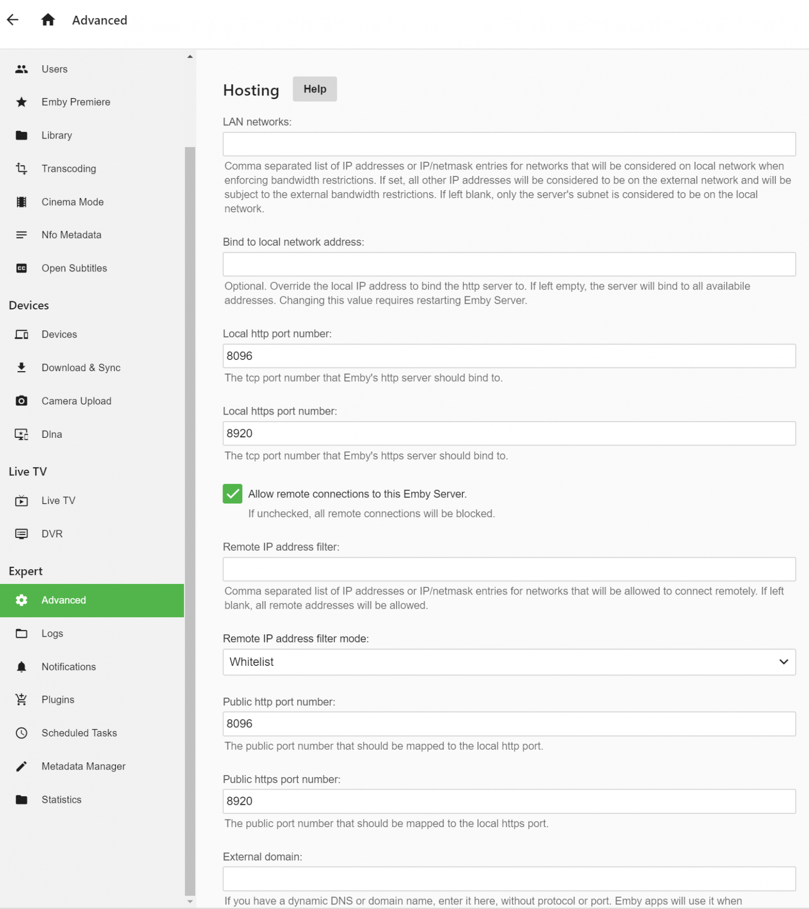

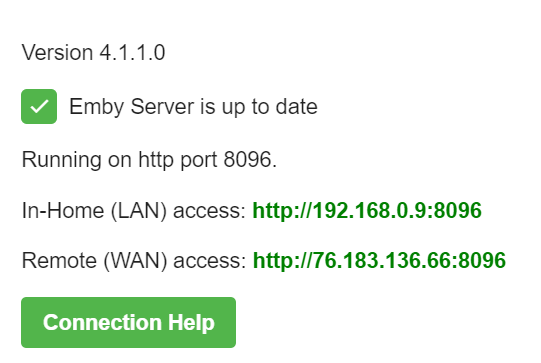

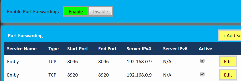

MrSerendipity 0 Posted June 5, 2019 Posted June 5, 2019 I'm just getting my Emby server set up at a new place for the next few months and I can't seem to connect anymore. I have my Firewalls set up to allow 8096 and 8920. I've set up Port Forwarding on the Router for both 8096 and 8920. But I'm still getting nothing. I think the issue is in my WAN address maybe? When I'm setting up the rule in my modem, I'm setting it up for 192.168.0.9, which appears to be the address assigned to my PC. Am I supposed to be setting up the port forward with my WAN address? It starts with 76.183.etc.etc and my modem won't allow me to replace 192.168.0 when I go into Port Forwarding.
Luke 42221 Posted June 5, 2019 Posted June 5, 2019 But I'm still getting nothing Hi, what do you mean by this? I'm setting it up for 192.168.0.9, which appears to be the address assigned to my PC. Am I supposed to be setting up the port forward with my WAN address? No, it sounds like you've done it correctly.
MrSerendipity 0 Posted June 5, 2019 Author Posted June 5, 2019 Hi, what do you mean by this? No, it sounds like you've done it correctly. As in, nothing will connect outside of my PC.
MrSerendipity 0 Posted June 6, 2019 Author Posted June 6, 2019 (edited) Here are a few more pictures if they can help anyone identify the problem I'm having. Edited June 6, 2019 by MrSerendipity

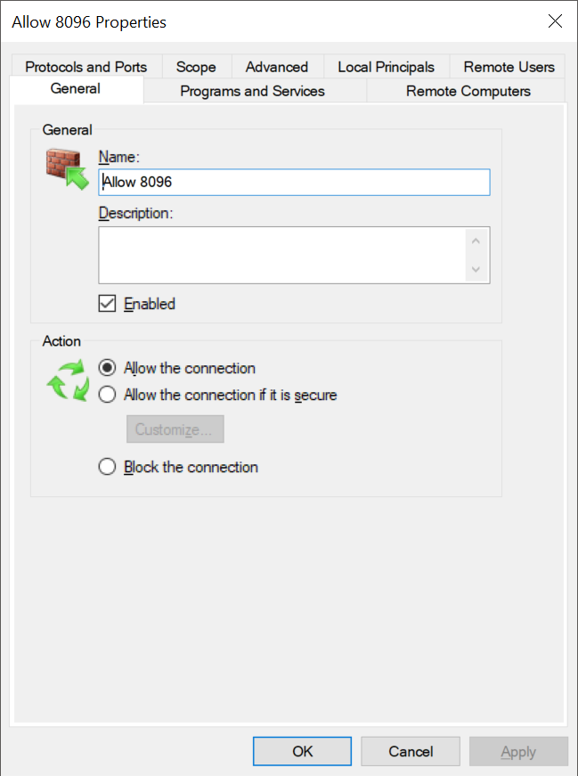

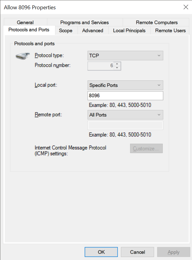

WilhelmStroker 107 Posted June 6, 2019 Posted June 6, 2019 You need to allow 8096 under protocols and ports in that screenshot, not where its currently configured.

MrSerendipity 0 Posted June 6, 2019 Author Posted June 6, 2019 You need to allow 8096 under protocols and ports in that screenshot, not where its currently configured. I have them set up like this. Is this wrong?
MrSerendipity 0 Posted June 6, 2019 Author Posted June 6, 2019 Ah yes sorry my bad, that looks OK to me. No problem man, I appreciate you trying to help me. This would indicate your firewall is also blocking the port(s). I just found the problem. There are like five Emby app selections in the "Allow Apps through WDF" and one of them was unticked. I ticked it and now everything is fine. Thanks so much for all of the support.
