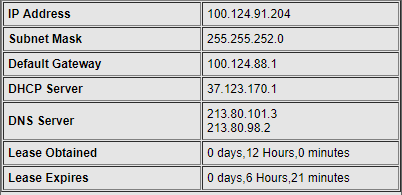

Wondertje 10 Posted June 6, 2019 Author Posted June 6, 2019 (edited) Alright, so here's what I've got (apart from the port forward above). I can confirm that the two addresses don't match. Router info whatsmyip.org Emby Now that you mention it, I do remember that PleX always used to tell me that I had some issue with "double NAT", but I never really understood what that was and just gave up. On the physical aspect of things, my router (which is a general one, not ISP specific) is plugged straight into the wall where I have my Ethernet outlet. When I used cable it went straight from the outlet, to the computer. Now that I've got my router I have a cable from the outlet, to the router and then another cable from the router to the computer (if I use it) and also of course Wifi setup, which is what I usually use. I do live in an apartment complex, so I'm not sure how the jack in my wall is actually connected to the rest of the system - there might be another modem/router/firewall/whatever that I don't have access to. Could it be possible that there's nothing I can do about it? Edited June 6, 2019 by Wondertje

Q-Droid 1003 Posted June 6, 2019 Posted June 6, 2019 (edited) Now that you mention it, I do remember that PleX always used to tell me that I had some issue with "double NAT", but I never really understood what that was and just gave up. On the physical aspect of things, my router (which is a general one, not ISP specific) is plugged straight into the wall where I have my Ethernet outlet. When I used cable it went straight from the outlet, to the computer. Now that I've got my router I have a cable from the outlet, to the router and then another cable from the router to the computer (if I use it) and also of course Wifi setup, which is what I usually use. I do live in an apartment complex, so I'm not sure how the jack in my wall is actually connected to the rest of the system - there might be another modem/router/firewall/whatever that I don't have access to. Could it be possible that there's nothing I can do about it? Yeah, basically your router is connecting to private network behind 155.4.131.191 and therefore not visible to the internet. As a tenant in an apartment complex it's possible your landlord or the ISP manage the network and you have fewer options. Double NAT is usually easy to fix if you have access to the equipment. But your case is more like CGNAT (Carrier Grade NAT) where the provider is controlling this and not likely to make an exception for you. You could find out from your landlord who manages the network. There's something called ngrok that is supposed to work around CGNAT but I've never used it. It has free options though I don't know how well it would work for streaming. Edited June 6, 2019 by Q-Droid
Wondertje 10 Posted June 6, 2019 Author Posted June 6, 2019 Do you have an ISP modem and a routher that you bought, separately? What internet hardware do you have and how is it connected? No, my hardware looks as follows: Ethernet outlet in wall --> Cable --> Router (not ISP modem nor ISP specific) --> Cable --> Computer Alternatively Ethernet outlet in wall --> Cable --> Router (not ISP modem nor ISP specific) --> Wifi --> Computer Yeah, basically your router is connecting to private network behind 155.4.131.191 and therefore not visible to the internet. As a tenant in an apartment complex it's possible your landlord or the ISP manage the network and you have fewer options. Double NAT is usually easy to fix if you have access to the equipment. But your case is more like CGNAT (Carrier Grade NAT) where the provider is controlling this and not likely to make an exception for you. You could find out from your landlord who manages the network. There's something called ngrok that is supposed to work around CGNAT but I've never used it. It has free options though I don't know how well it would work for streaming. I did order the internet myself form my ISP. I was given a choice from a list of ISPs when I moved in. I'll probably contact them and ask if there's anything they can do then and see if it can be resolved. I'll look into ngrok too and see if it could help me. Thank you so much for all your help, it's greatly appreciated! 1
