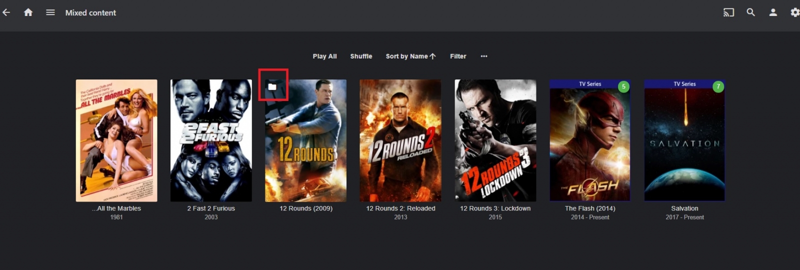

MndWrp 101 Posted June 3, 2019 Posted June 3, 2019 I've been looking around the forum for an answer on this but nothing found. Basically my mixed content libraries have both movies and series (documentaries for example, Cosmos would be a 'series' type, and Baraka would be a 'movie' type) and both have the usual folder structures. The 'series' types work fine but the 'movie' types require an extra depth of navigation to get to the content. So if i hit Baraka i end up on another page that has only Baraka and when i enter that one, i get to the details page of that movie. Is there a way to eliminate that extra annoying layer ? Which seems quite useless i my opinion... Can i do something on my end to fix that ?

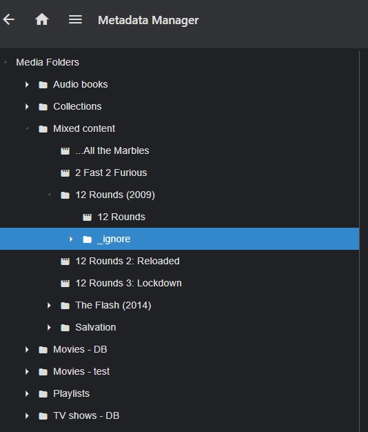

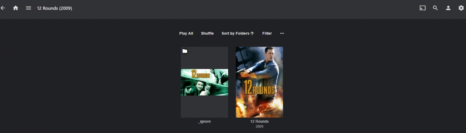

Happy2Play 9806 Posted June 3, 2019 Posted June 3, 2019 With a quick test it is the _ignore folder. What do you see when you navigate to a Mixed content movie in the Metadata manager? What do you see when you enter a Movie? my test example cause movie to become folder entry.
Happy2Play 9806 Posted June 3, 2019 Posted June 3, 2019 (edited) @@Luke putting a ".ignore" file in the "_ignore" folder hides the folder but maintains the extra layer entry. Only tested Mixed Content, but that is where most of these anomalies exist. Edited June 3, 2019 by Happy2Play

Luke 42217 Posted July 29, 2019 Posted July 29, 2019 The _ignore underscore has never been a supported folder name. What's happening is, we've fixed a bug, however you've gotten used to the bug and you want it's behavior to continue. Let me explain. Suppose you have a movie folder with a movie file, and inside that movie folder, another folder called random with video files inside that. What used to happen before is the movie file would end up owning the whole folder and those files inside the random folder would never be accessible in Emby. Now we've resolved that, but the side effect is that if you have non-recognized folder names under your movie folders, then this will happen. Your _ignore folder is being treated as library content. What are the contents of the _ignore folder?
One2Go 120 Posted July 29, 2019 Posted July 29, 2019 While i totally get what you're saying, I'm in no way trying to rock the boat for my own goals. However, when a feature used to work fine in the past, and got broken along the way, i think it's fair to ask the devs to look into it, making the boat stronger for all of us. Sent from my SM-G920W8 using Tapatalk I get what you are saying and I navigate any possible dilemma in a different way. When I reach a version that I am happy with because it does 90% plus of what I want it to do, I stop updating for fear it will break something or in your case an advantages bug for you is being fixed that breaks now your routine of organizing and navigating your collection. Just my 5 cents worth.
MndWrp 101 Posted July 29, 2019 Author Posted July 29, 2019 (edited) The _ignore underscore has never been a supported folder name. What's happening is, we've fixed a bug, however you've gotten used to the bug and you want it's behavior to continue. Let me explain. Suppose you have a movie folder with a movie file, and inside that movie folder, another folder called random with video files inside that. What used to happen before is the movie file would end up owning the whole folder and those files inside the random folder would never be accessible in Emby. Now we've resolved that, but the side effect is that if you have non-recognized folder names under your movie folders, then this will happen. Your _ignore folder is being treated as library content. What are the contents of the _ignore folder? I understand the library content part, but shouldn't what's in the folder, or it's name be irrelevant since it also contains an .ignore file. Theoretically my folder might as well named "_potato" and it should be ignored since i placed an .ignore file in it... no ?? Or is the beginning underscore evil in some way? I just put it, so the folder is first alphebetically. Edited July 29, 2019 by MndWrp
