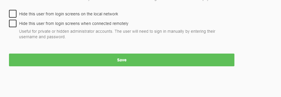

I just deleted everyone and added them back
Happy2Play
Looking at that User screenshot you have disabled Remote access via Dashboard-Advanced-Hosting menu "Allow remote connections to this Emby Server."

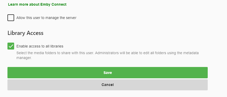

Guest keithcq71
Thanks. So I need to have allow this user to manage this server enabled?
Guest asrequested
No, just access. Unless you want them to have control of the server. I wouldn't suggest that, though. And make sure everyone has good passwords.

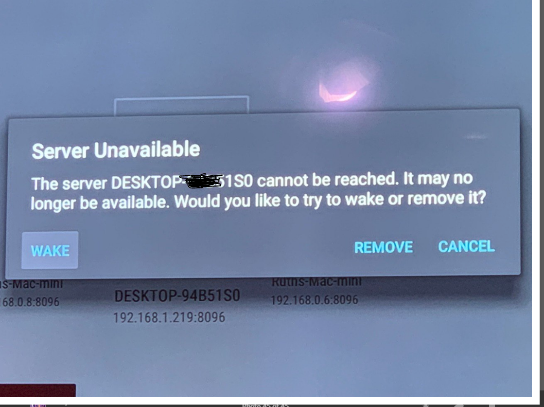

Guest keithcq71
Guest keithcq71
I have enable access on . Am I missing something?
