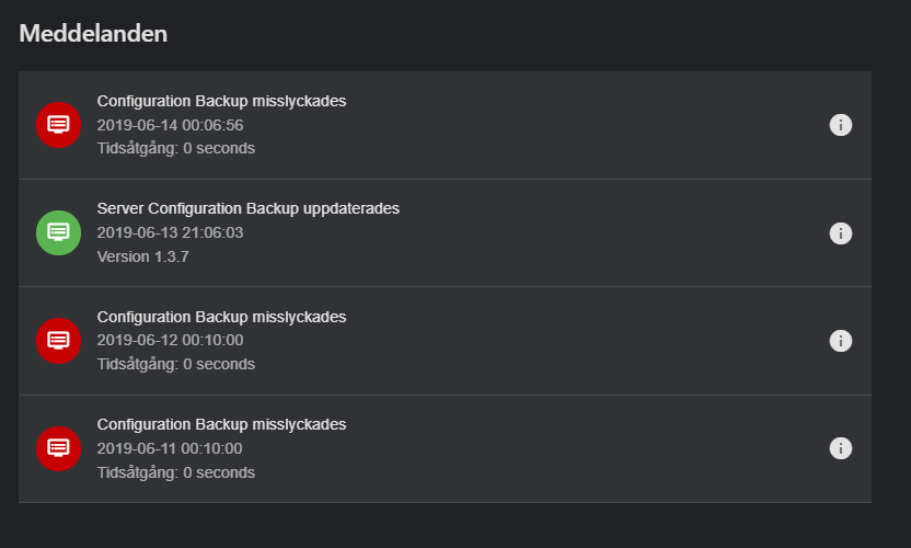

NikeSwe
Also seeing this. Running latest beta.
Notification says this:
Emby Backup trial has expired. Please purchase Emby Premiere at https://emby.media.
at MBBackup.ServerEntryPoint.ExecuteBackup(BackupProfile settings, CancellationToken cancellationToken, IProgress`1 progress, Boolean isAuto)
at MBBackup.Entities.ScheduledBackupTask.Execute(CancellationToken cancellationToken, IProgress`1 progress)
at Emby.Server.Implementations.ScheduledTasks.ScheduledTaskWorker.ExecuteInternal(TaskOptions options)
(it has not expired)
Getting it almost every night. Running manual works sometimes, sometimes not.
Got update just now. First manual backup after update, same failed message. Followed up with another try, no error message.
