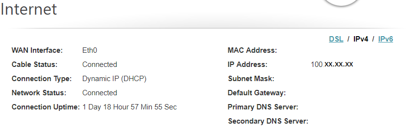

Joe Farmer 2 Posted June 3, 2019 Author Posted June 3, 2019 1.) go to https://whatsmyipaddress.net/ and verify that your public ip address is the same that the router sees. - It's the same as the Remote (WAN) access IP in Emby (119.xx.x.xx) but not what my router shows as you can see below. Though I'm not sure if they should be the same? 2.) If different then I would try the ip address that's identified there. - Not sure what you mean by "try the ip address that's identified there" but if you mean try to connect that the router IP externally ie. 100.xx.xx.xx:8096 I have tried that and it doesn't work. https://canyouseeme.org/ also shows the 119.xx.x.xx IP that is in Emby and https://whatsmyipaddress.net/. 3.) If that doesn't work, I would also check your firewall on the server to see that there are rules setup to allow traffic in on the ports that you are using for your server. - There are two inbound rules for Emby and one for Port 8096 as below: I don't see any outbound rules for Emby or Port 8096 though, do I need outbound rules?
Solution Joe Farmer 2 Posted June 3, 2019 Author Solution Posted June 3, 2019 SOLVED!!! Aussie Broadband had opted me in to CG NAT without my permission which lead to port 8096 being blocked on their end. They turned it off and after a router and Emby reboot my remote access is now working again. This topic can now be marked as solved.
rbjtech 5338 Posted June 3, 2019 Posted June 3, 2019 SOLVED!!! Aussie Broadband had opted me in to CG NAT without my permission which lead to port 8096 being blocked on their end. They turned it off and after a router and Emby reboot my remote access is now working again. This topic can now be marked as solved. Many ISP's are doing this now - and it's effectively an ISP using a pool of PRIVATE IP's which is then NAT'd to a single PUBLIC IP - much like your home network does. For browsing this works ok but if you want to HOST something (such as Emby) then you can't do this - as you found out - as you get their 'PRIVATE' IP allocated, not a real 'PUBLIC' IP. Glad it's sorted.
